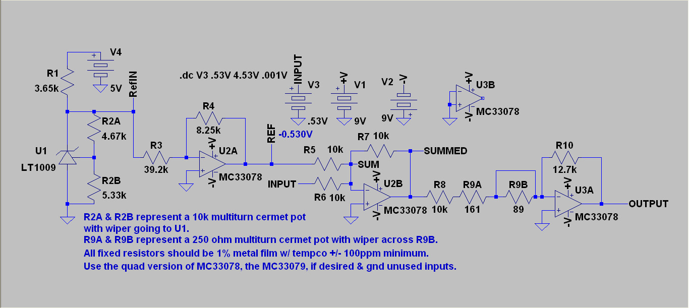

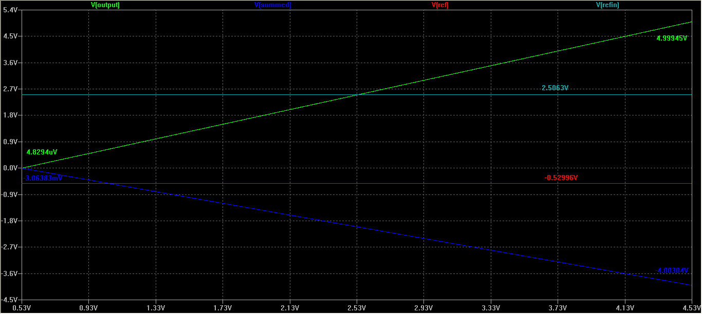

Read your post this evening and I can see multiple issues with your circuit. I came up with an alternative, which should much more closely meet your criteria with a great deal more accuracy. The schematic and DC sweep plot (0.53V-4.53V) of the 4 significant voltage points are attached below.
Calibration of the two output end points is as follows using very accurate DMM (+/- 0.1% DC or better):
1. With the sensor attached at 0 lb. pressure and power applied, measure voltage across inputs, NOT junction, of R5 & R6. Adjust R2 for 0.0000V.
2. With the sensor attached at 500 lb. pressure and power applied, measure voltage from output to ground. Adjust R9 for 5.0000V with expected load on output.
3. Repeat step 1 to ensure the voltage is still 0.0000V then measure output again as in step 2.
4. The output should then follow the sensor output, upon which the linearity of the output depends.
A few last remarks. I would strongly recommend bypass caps, .1uf, at all supply points. If you use the MC33079 that would take 2 at pins 4 & 11 and another on the 5V supply to U1 at R1.
I'd be happy to answer any questions you may have regarding the circuit. Good Luck with your project.

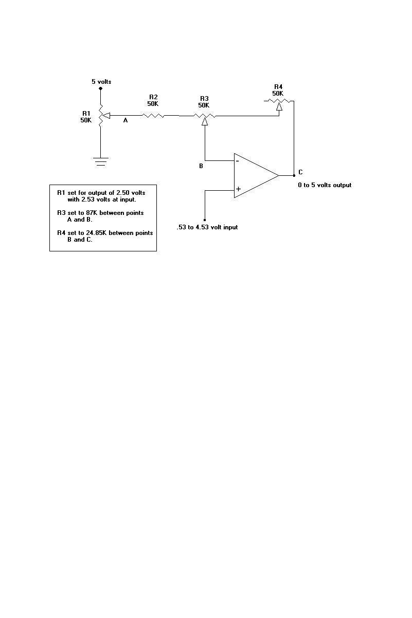

I want to thank everyone for your replies. I tried the circuit suggested by MRCecil with the following changes. I replaced U1, R1 and R2 a and b with a 50k pot. I also replaced U2 and U3 with 1458 opamps. I made these changes, to test the circuit, because I allready had these items at home. The circuit works fine with these components. I am now wondering if I should use the components I allready have, or replace them with the parts in the original circuit, as suggested?
