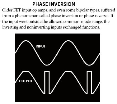

When the wiper of the pot is within a few volts from the negative supply (ground) then the problem of Opamp Phase Inversion causes the output to go high. The output is supposed to go high when the non-inverting input (the wiper of the pot) is higher than the inverting input.

No it can't be fixed and has nothing to do with the supply voltage. The inputs do it when they get near the negative supply voltage (the common mode voltage limit). Newer opamps do not have the problem.
