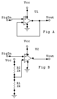

I'm going to try to attach some circuits. One is an Op Amp as a non-inverting buffer. Since you didn't post your power supplies, input signals and desired output, I'm just guessing. I looked at some datasheets for the 741 and I don't see that it is recommended for single ended supplies. If you don't have split supplies, an inverting buffer is not going to work. The other circuit is using the Op Amp as a comparator. Comparators, like the LM339 or LMV331, generally work better as compartators than do Op Amps.
j.

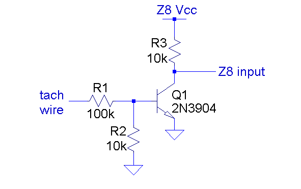

I just got back from testing... Thinking back to the theory that current drain from the tach signal wire being the problem... I used just a 10k POT and that worked fine...
I adjusted the pot to about 3.5k between tach signal and z8 input, and 7.5k between z8 input and ground (any naturally, 10k between tach signal and ground).
This obviously did the trick. The z8 is seeing a high enough voltage to trigger it's input pin interrupt, and the resistance is enough to stop the z8 from being enough of a current draw to zero out the dash tach.
Do you guys think this would be a good enough solution - or am I doing something stupid here?

Obviously, the pot works. It is not a very reliable solution. If signal polarity doesn't matter, use a transistor as a level translator, as below. It will invert the pulse, which shouldn't be a problem.
Forget about using a 741 op amp as a level translator. The output will not get nearly close enough to zero volts with a single supply. There are comparators that are designed for this purpose, but they are overkill for this application.
Russlk said:
The problem with the original circuit is that the 741 will not operate from a single supply unless the inputs are biased above ground.
That's not the only problem. The output will not pull down to GND, according to the specs and a simulation of two different models. I don't have one to experiment with. The schematic in **broken link removed** implies that a resistor from the output to ground might give you a "soft" zero volts. I certainly wouldn't count on this to work, especially from all mfrs. If you used the 741 as a comparator instead of an op amp in this application, a voltage divider on the "reference" input would solve the common mode voltage problem. As I said, I think any sort of a comparator is overkill in this case.
