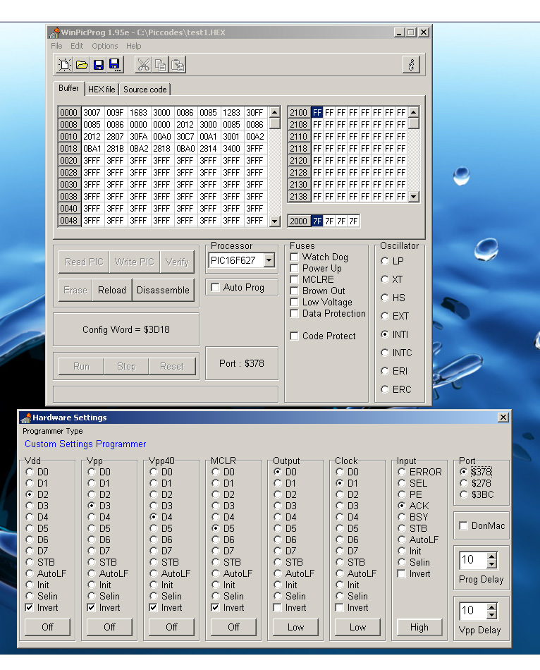

Thanks for the input Aljamri, maybe that would work, but at the mo I can't get the PIC into program mode( well my Velleman 8048 says its not there at all !) even though when I switch to run mode it runs OK.
What I am trying now is using WinPicProg instead of the one that came with the Velleman programmer, but I have another problem now, does anyone know if WinPicProg will actually work with the Velleman as was suggested by Picasm, and if so what do I need to do on the settings, there are settings for VPP, Data, etc and I have no help file, so I'm lost.
This is my last effort before I have a go at building a new programmer (the oshonsoft) suggested by Eric, but a snag again, it requires a 74LS06 and the closest I have is a 74LS04, they look pretty much same spec wise if the voltages won't hurt the 04 that is, if you know give me a shout.
Thanks again.........Al

Hi Picasm,
Sorry to be asking again, but where do I put the above info?
I have included a screenshot of my WinPicProg with the only hardware option screen I can find, I'm stumped :eek:
AL
PS there are no other files in the Zip, just the beta.exe

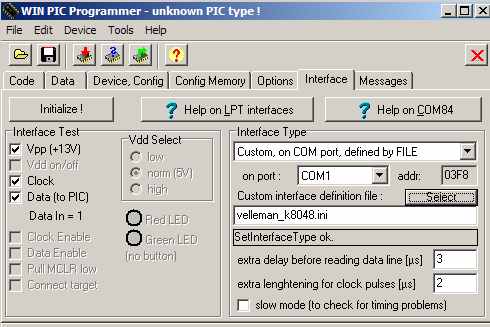

It is set-up by clicking on the "Interface" tab.
The help file is in the C:\Program Files\WinPic\html folder after you have installed Winpic
Note that I gave you the link for "winpic" not "winpicprog" which is a different program
Hi Picasm,
Sorry mate, forgot to upload my screenshot, I cant find the part you got on your WPP! Help
Al
picasm said:
You have the wrong program - you need "winpic" from the link I posted earlier.
DOH!
Thanks mate and sorry for being a bit thick, I have a cold, well thats my excuse to the missus anyway!
I'll let everyone know how I get on.
Al
Whoopie I can program again!
Hi folks,
Thanks Picasm for the excellent advice on the software, like you said the Win Pic Prog does indeed support my Velleman, and controls it way way better than their own software ever did.
Now reprogramming the 16F628A isn't a problem, at last!
