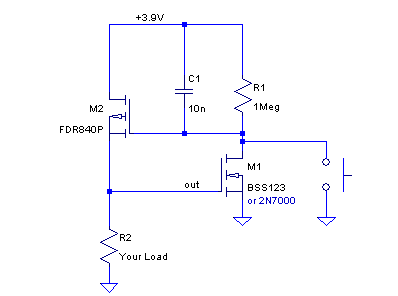

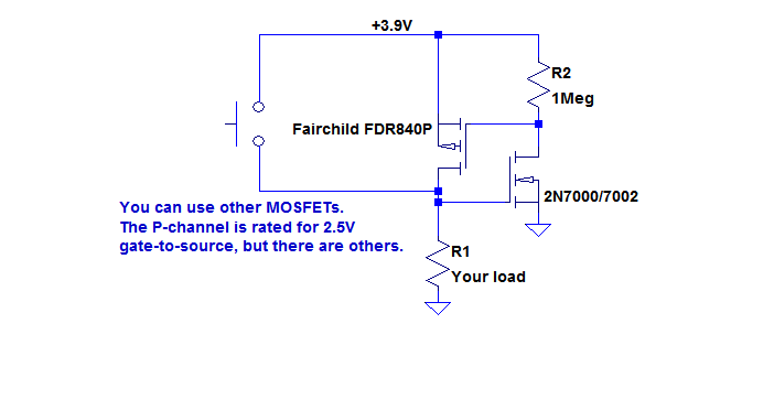

Sorry, I re-read my post and it look stupid, I'm talking about having a switch to force a relay to switch something on!!!! I know this sounds stupid, but here why I want it.
The critera
IP67 rated box
Switch only works once to turn on but CANNOT turn off
No current consumed by the switch before or after turned on
Project has a sealed box and I have found a IP67 rated push switch, the idea being to have have access to the switch. The user pushes it (project powers up) and now it's on until the battery goes flat, and nothing can turn it off.
Hope this makes it a little clearer
This will draw nothing until it is switched on. When on, the N-channel MOSFET will draw 3.9uA.

But even a big SCR will drop around 0.8V at 3 amps. That's a pretty big percentage of 3.9V. The MOSFET solution will drop around 30 to 40 millivolts.

If you do decide to use the MOSFET solution, this is an alternate method. You probably should add the cap in either case.
