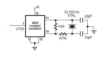

I found the attached circuit on the web.
I've seen that before, it will work but the frequency is 2Hz, if you want 1Hz, you'll need a divide by two counter which means adding another IC.

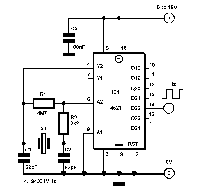

The HEF4521 and 4,194,304Hz crystal seem like the most compact and simple option to me.
I agree and would like to use your suggested circuit.
Due to the low resolution of web images, I can not make out the text very well.
Could you please post the component values?
I've neatened it up for you.

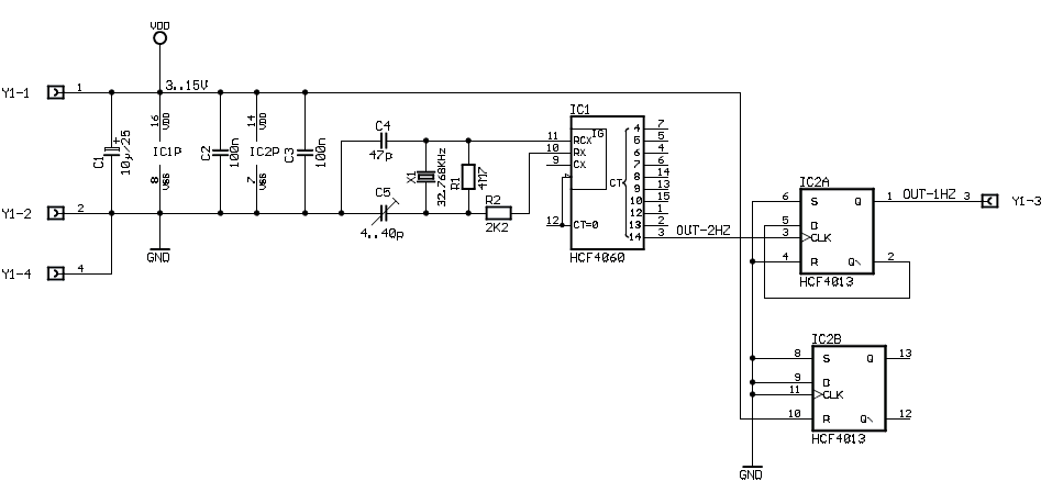

I'm pretty sure the CD4060 is a single chip solution for the 32kHz osc + 1Hz output.
If you use a HCF4013 Flip Flop connected to Q14 you get 1Hz. Oscillator frequency 32.768KHz/16385=2Hz.

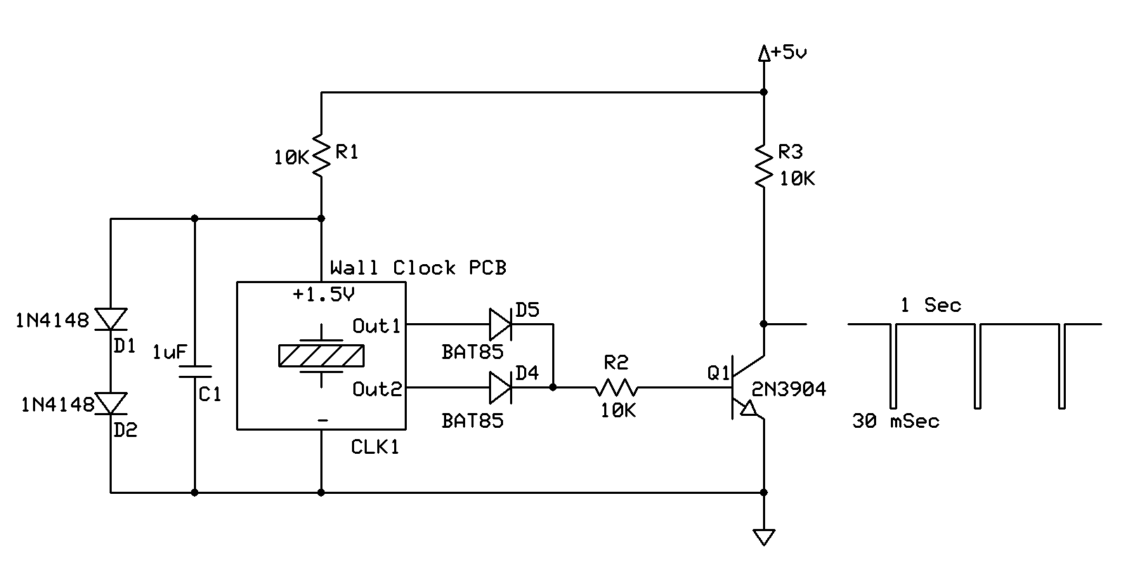

As colin55 said in post #2, just use the 1HZ output from a 1.5Vbattery desk/wall clock. Cheap, easy, and accurate.
