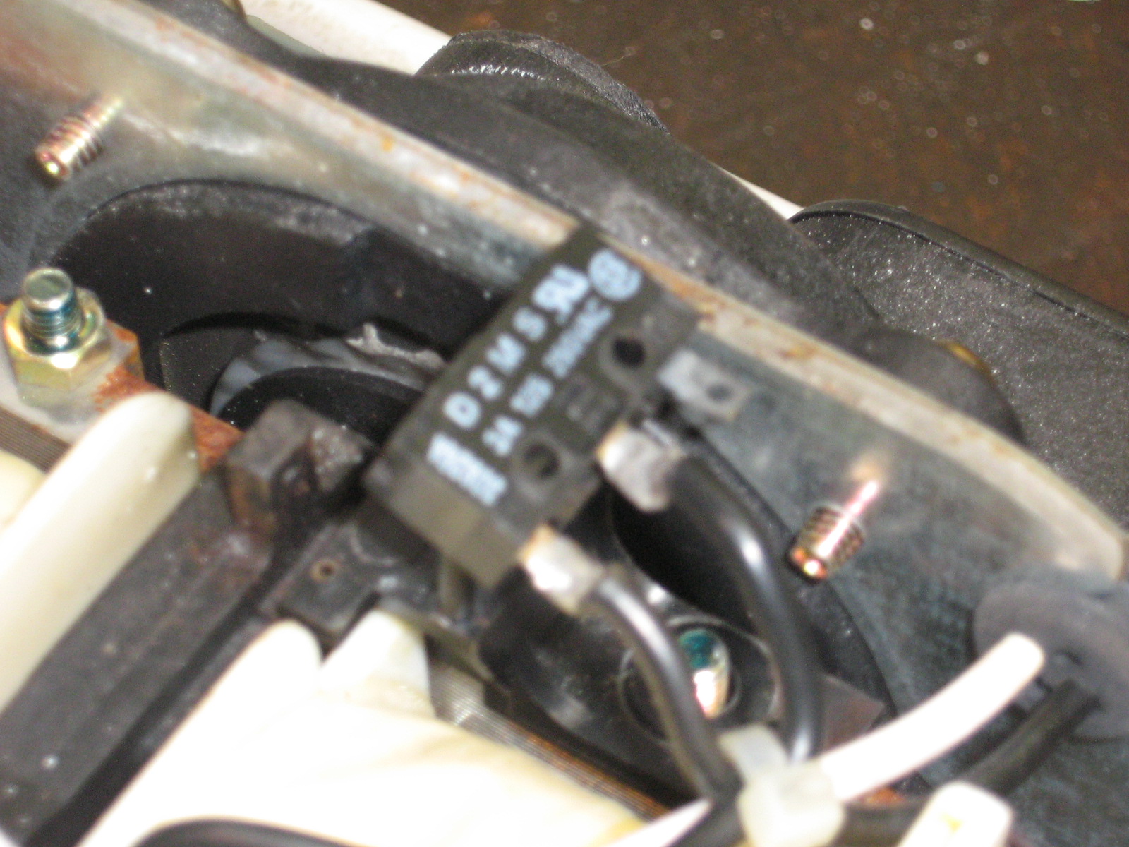

Im working on an air blower that seems to work on a vibration/oscillation between 2 transformers.
There is a limit switch on the oscillating part that seems to cut out the power if for some reason the movement stops. i cant find a new one.
Its an Omron D2MS 3092RA thats rated at 3A 250VAC
Ive phoned Omron but its off their systes so i guess its not supplied to the UK any more, RS has D2MQ switches but im not sure if they are direct replacements.
Any ideas?

Any chance of a clear photo.?:)
Cant find any info on the OMRON.
Here is a photo of the switch, the live is switched through the common and NO.
It is mounted ontop of 1 transformer and the black part you can see to the left of the photo moves back and forth when the transformers are powered. i think this part holds the micro switch closed in operation and if this were to move away from where it should be the switch will open cutting the power.
I need to know if this can be purchased or if there is a direct replacement.

Has the operating lever on the existing µSw broken off.?
I've looked at the RS site, the switches appear to be the same.
The two transformers are most likely solenoids which pull an armature back and forth.
yeah i reckon the little arm must have broken off. i think my best bet is to check the dimensions and ratings are the same as on RS and buy if they are.
Get the highest current rated uSw from RS that will fit.:)
