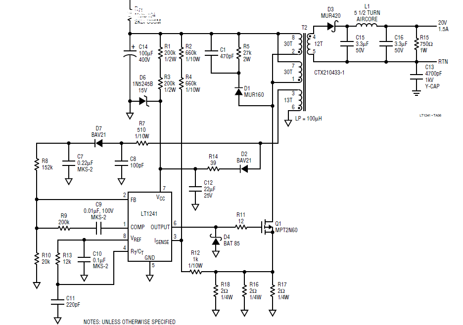

Hello,
Do you see any problems with this (non-optocoupler based) isolated feedback method for offline SMPS’s? Why does nobody do it like this?
The attached schematic shows what surely must be a total revolution in isolated feedback for offline SMPS’s? –It allows the feedback signal to cross the isolation boundary without recourse to an optocoupler. (instead , a digital isolator is used, freeing the engineer from the opto with all its inherent problems such as poor parameter tolerance and ageing problems )
With the error amplifier on the secondary side, the feedback signal takes the form of a variable duty cycle square wave, produced by a simple PWM controller IC. This is passed across the isolation boundary by the digital isolator. On the primary side, the PWM error signal is filtered and then fed to the PWM comparator in the primary side PWM controller IC. –Hence the SMPS output is regulated
There is also the LTspice simulation attached.
What’s wrong with this way of doing it?
Why does nobody do this?

Where did you get this schematic?
Too many parts.
Here is a 1 IC option.
Its more parts than an opto, but far more robust, and is simpler and cheaper than a feedback method using a high frequency transformer, which is the other non-opto alternative.....the transformer may well go obsolete, and you then have a harder job to replace it than just replacing a digital isolator....the extra parts are worth it to avoid an opto...opto's are a big problem for isolated feedback loops, due to their poor temperature performance, ageing, and poor parameter tolerance...those parameters, I hasten to add, are intrinsic to the feedback loops very operation....not good news for optos, optos are bad in the feedback loop of an SMPS.
where did I get it?, well I kind of hacked it from an idea schematic in the Raymond mack book "demystifying switching power supplies"
thanks, I see your attachment now, you are using bias winding feedback, which is fine , but gives poor tolerance to vout, and poor transient response in vout. Especially in offline flybacks where the bias coil has a significant filter with it so as to filter the leakage spike away.

thanks but I don't feel very clever when I see the dreadful no-load to full-load transient response of this digital isolator SMPS. Here it is running alongside a non isolated SMPS in LTspice..any ideas to improve the dreadful undershoot at no-load to full-load transient?

What’s wrong with this way of doing it? Why does nobody do this?
If you look at the datasheet for the digital isolator you will see it's over-printed "Not recommended for new designs". I suspect that's your answer. Perhaps the manufacturers have discovered a problem, even if they are not telling us what it is.
It doesn't really matter about the particular part number of the digital isolator, its the principal of using a digital isolator in this way...there are digital isolators in the market that could be used in this scenario, the question is, why are they not being used as such?
Probably costs more than the opto route. Principles don't count when it comes to marketing :)
