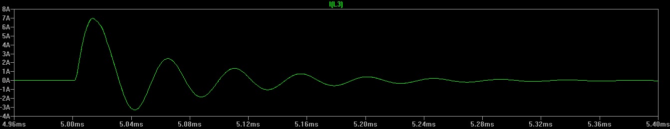

According to the sim, those caps are prolonging the ringing on the +ve rail from ~30uS to ~100uS and are introducing an extra 12A or so RMS current pulse over that ~100uS at switch-on. I'd be surprised if that would tip the balance and cause things to fry, unless some component were already stressed, but who knows?

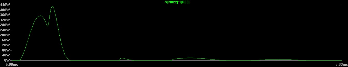

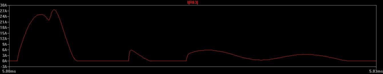

Do you think that the attached surge current waveform would be likely to blow up the 1206, 0R56 resistor?
The power waveform is also shown.
Unfortunately the ERJ8BQFR56V datasheet doesn’t allure to its surge handling capability.

There is only ~1mJ of energy in the R63 pulse over its ~30uS duration. If you know the thermal capacity of the resistor in situ you can calculate the temperature rise :).
Thanks, its the 400W pulse for 5us which makes me wonder if the 1206 can handle this.
I know it seems like only small energy, but when you have specific surge resistors, its amazing how such small bits of energy in tiny bits of time can kill it. The current pulse does go up to 27A, and i think the 1206 bond wires just literally get shocked off their connections and it dies?
I notice that the 1206 , SG73-RT resistor is surge rated but over any <10us interval the power goes to 1000W or more it will blow up, as its datasheet tells...

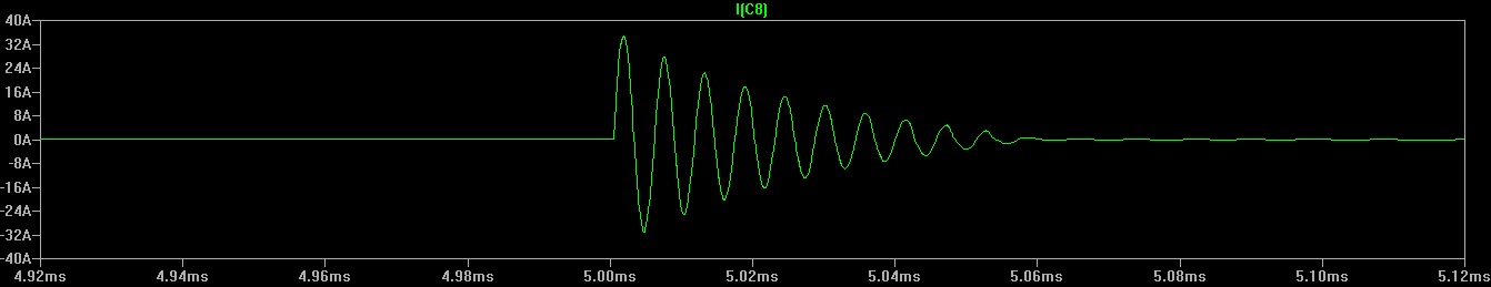

On the AC fuse note, the attached inrush current through the 1A Schurter 3403.0166 (1A) fuse is above 10A , and the fuse datasheet seems to suggest that anything above 10A is not allowed, even for microscopic instants of time. The datasheet does not list any break time for currents above 10A for the 1A fuse.

have you tried a small amount of resistance in series with the input caps, C8 and C1. If you apply a step function to an LC tuned circuit, the output voltage will ring up to 2x the input step. This is what you are doing when you close the switch. the upstream inductance is ringing with the newly added capacitance and the input voltage is ringing above the voltage you expect it to be. The Transorbs are conducting the shooting a high current through the sense resistors.
This is my humble opinion after looking at the circuit for all of 2 minutes.
Series resistance will add damping to the LC circuit formed by L1, L2, C1, C8 and damp the spike, so the transorbs don't conduct.
