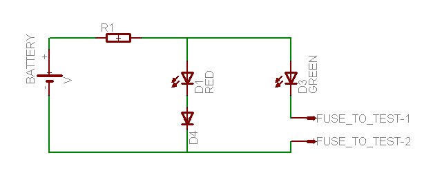

oh, 1 last thing, in school, we are doing a simple circuit (and case) to test a fuse i.e, if the fuse works, the LED will come on, i was wondering, would it be possible to use a relay so if the fuse works a green light comes on and if it doesnt, a red light comes on? or would i need a 555 timer or similar IC (sorry if this sounds stupid, i'm a beginner lol)

hi, could you explain that circuit please? my sisters friend (an electrician) says he doesnt see it working, but he may be wrond, the diode limits the current to only flowing one way right? doesnt the LED also do this? (only lets current flow one way)
im a little confused about it :s
With apologies to your friend, but electrians know absolutely NOTHING about electronics! - you wouldn't believe the bodge job most of them make attempting to wire aerial systems in new houses!.
The extra diode is there to add an extra 0.7V drop to the red LED, this means that when the green LED lights it prevents the red one lighting as well.
ohhh i get it now, thanks he did say he didnt know much about electronics as it was ages since he did it, are there any specs for the diode i need or are they all the same?

Just a standard silicon diode, a 1N4001 would be fine, or even a small signal diode like a 1N4148.

A diode ONLY conducts in one direction (well their is the avalache case, but thats another story). An LED is just a DIODE that has been "tweaked" to emit light as well as block voltage
So a diode is a perfect silicon component to only allow current to flow in one direction (hence its use in a rectifier).
There is another proporty of a Diode. the forward voltage. When a diode conducts there is a voltage across the diode (it is exponential but for quick cct design assume it is constant).
So when the diode conducts it has 0.7V across it and it is constant (or there abouts).
An LED has a higher volt drop across it, 1.2V is a good rule of thumb as well.
IF you had a battery of 0.5V and put a diode across it, it would not conduct becuase there is not enough voltage to get over its forward-voltage requirement.
So you have a LED in series with a standard DIODE. The total volt-drop across it is 0.7+1.2 ~ 1.9V. So 1.9V needs to be present to allow that branch to conduct (and for the RED-LED to emit light).
In parallel with this Red-LED+DIODE branch is a GREEN-LED+test leads.
With a faulty fuse (ie open cct) the RED-LED+DIODE will conduct.
With a working fuse (ie it is a short-cct) the GREEN-LED will conduct, this will clamp that parallel branch at 1.2V, this is lower then the 1.9V needed to make the RED-LED branch conduct, thus the RED-LED will not light up and only the GREEN.
In thinking abt it you might want to put a momentary switch between the battery and the burn-resistor.
Different LED's/Diodes will have different current capability so be careful.
What LED's you choose (and what current capability) will determine what value of resistor is needed. That resistor has to drop the rest of the battery voltage (say a 9V battery and 1.2V is dropped via the GREEN-LED, then the resistor has to drop 9-1.2 = 7.8V)
another rule of thumb (that I use) is 10mA is a good current for a standard LED. more current the brighter they go

so, in theorey, if i put anything that uses a current in place of the diode, it will still work.... am i correct?

What diode, they are all diodes?
if you mean the non-LED, not really you need something there that has a signincant voltage across it (ie a diode with 0.7V) to increase the forward voltage for the path.
IF you put a resistor in its place then there will still be a slicht leackage through that path and the RED-LED will come on slightly - but then we start getting intot he exponential characteristics of diodes
