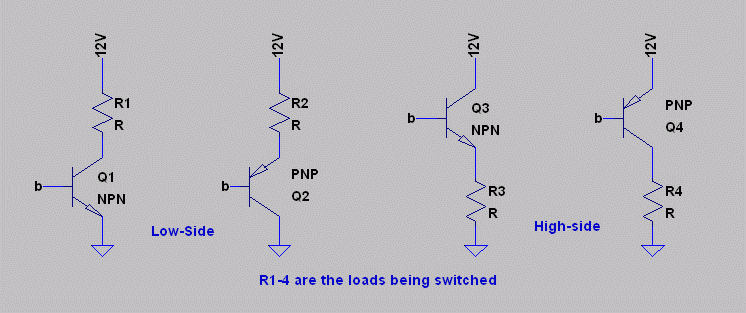

We usually describe this as a low-side switch or a high-side switch, based on where the switching transistor is placed.
There are four possible combinations, NPN, PNP either high-side or low-side. Which do you think you need?
What are you trying to switch? Resistive? Inductive? How much current? How much loss can you tolerate?
Can the 12V power supply negative be tied to the 5V power supply negative? Should it?

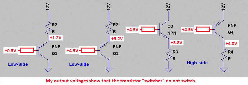

But 3 of your 4 circuits DO NOT WORK:

Off course they all work. All four have some values of V(b) where the respective transistor is either fully turned ON or fully turned OFF. I made no claim that all four of these circuits could be switched directly by a micro-controller port pin.

Not 'exactly', only 1 and 4 are 'switches', 2 and 3 act in a very poor analogue fashion rather than 'switching' - and are very poor examples, often used by people who don't understand what they are doing.

Or used by people who know exactly what they are doing, and why 2 and 3 have an advantage over 1 and 4 for certain applications...

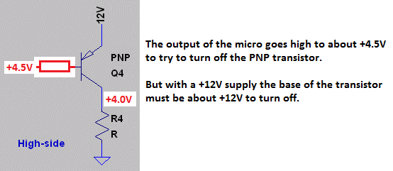

I agree with AG 5v switching from micro to 12V load will not supply.
NPN i.e. low side is working , but when i work at PNP with hide side it not turning OFF the PNP when base is ties up to 12V from pull up 10K it is OFF and for PNP the micro 0V and 5V remain it in ON position!

Tie the base to 12V via pullup resistor (10K or whatever). The micro then switches it by pulling it low (0V) and closes it by setting the pin to INPUT. 5V at the base will likely not turn it off.
I showed why it didn't work. Here it is with an explanation:
