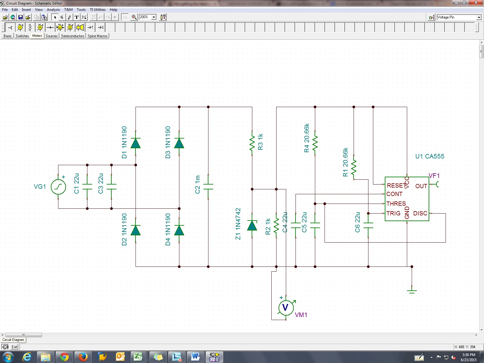

I implemented this circuit and am getting the output desired but what I observe is that if I dont connect anything across the Zener diode (i.e. if I remove everything after the capacitor connected parallel to zener diode) i'm getting a constant a 12V but if I connect everything I dont get a 12V across the Zener voltage regulator, basically there's a voltage drop.
Could you pls help in identifying where I'm going wrong or maybe I have chosen some wrong value of resistor or capacitor somewhere which is causing this drop, because I need a 12V across the zener voltage regulator when everything is connected.

1 It would help if your schematic was more readable. It is difficult to see the component values.
2 What is the supply? Is it supposed to be the 240v mains? If so this circuit is dangerous and should not be built as drawn.
3 Reducing the rectified mains with a resisitive dropper to give 12v is a very bad idea and the cause of your "voltage drop" when the rest of the circuit is connected.
4 Your supply smoothing capacitor C3 is probably too low a value, is in the wrong place.
All in all a good example of a bad circuit.

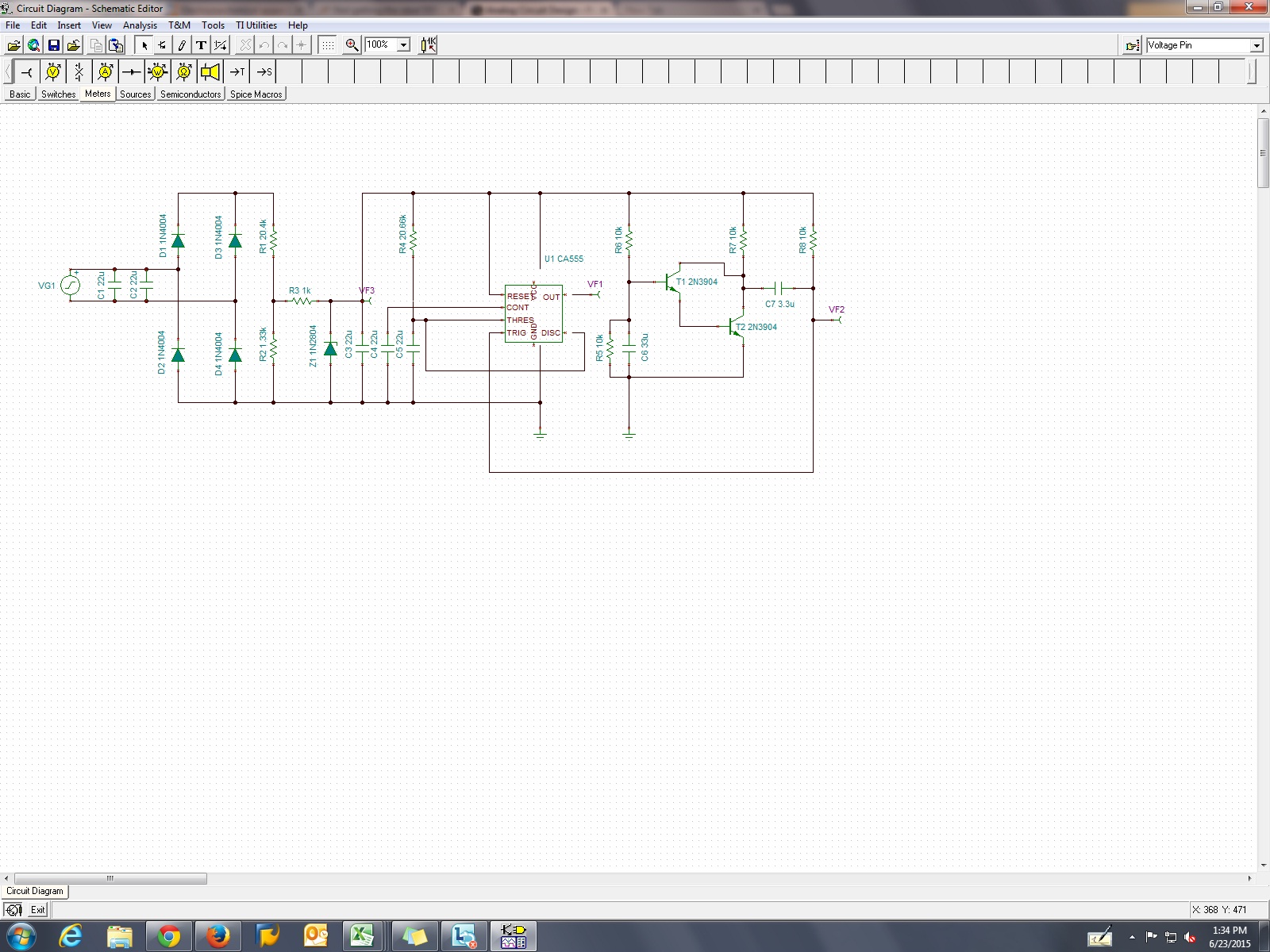

Ok uploading a more readable digram of it.
Yes the supply is supposed to be 230V AC Supply, and I'm taking proper measures to keep it away from any human contact.
So according to you changing the value of resistors and capacitor wont help in this case in obtaining a 12V output when the rest of circuit is connected? Maybe try to identify which is the load that is causing this voltage drop?

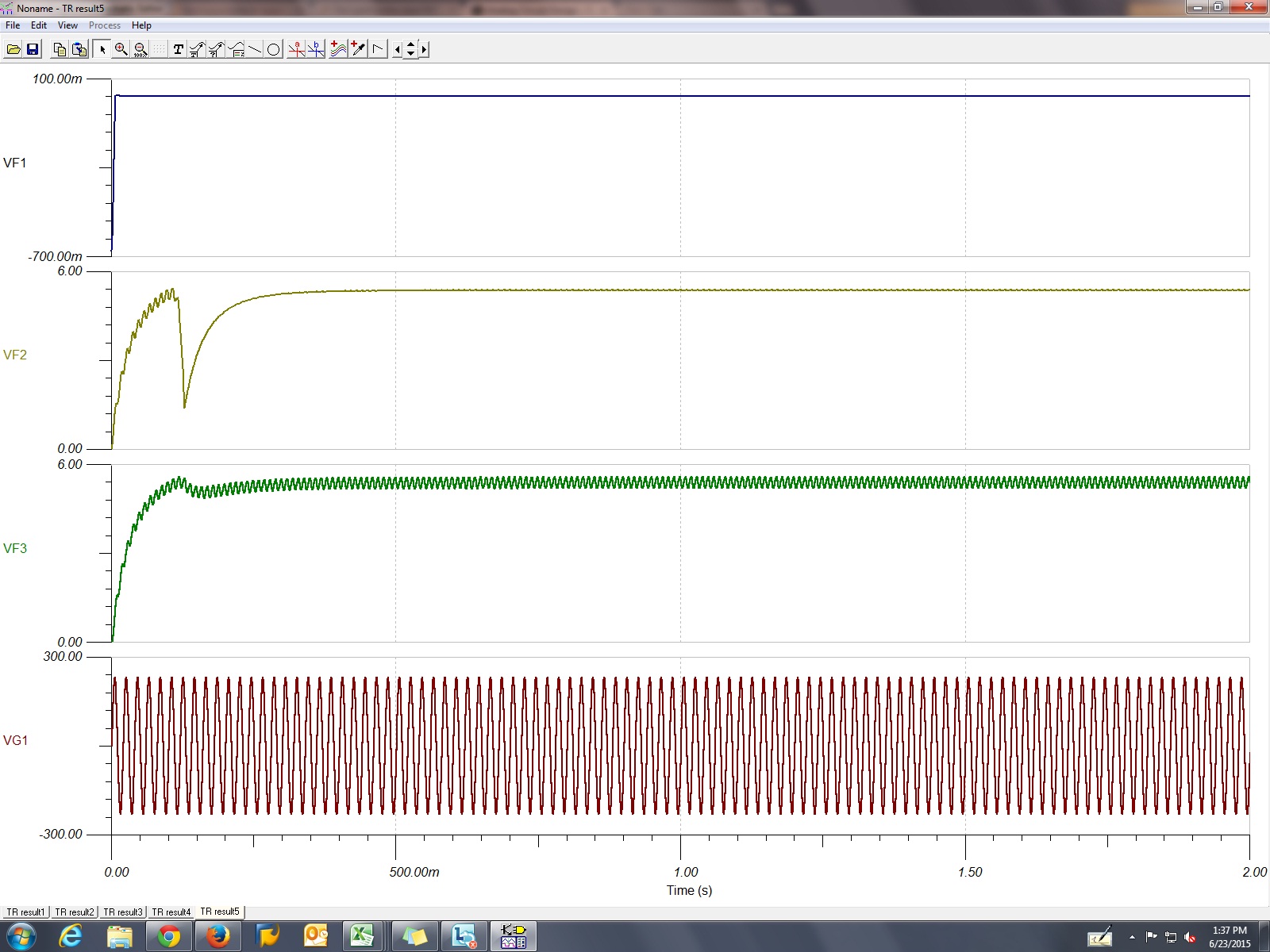

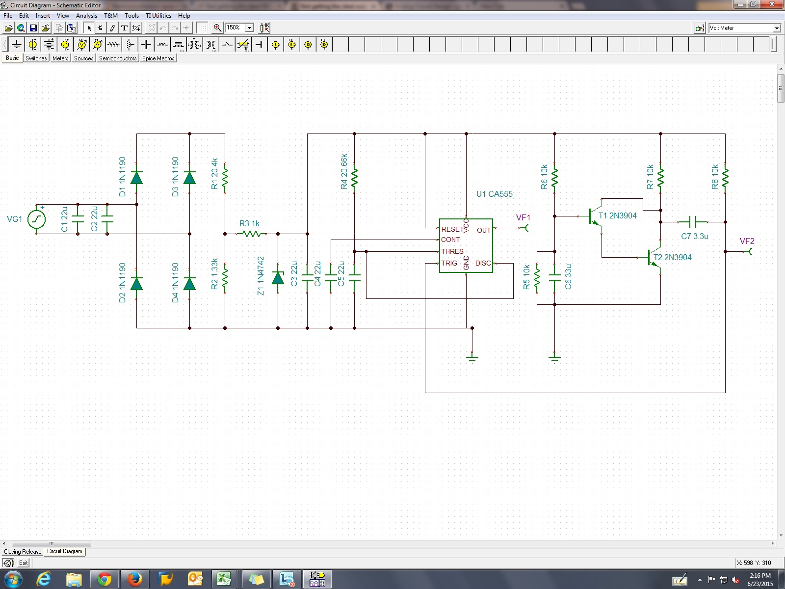

Ok made few more changes and now getting the right output..
https://obrazki.elektroda.pl/2404526100_1435052033.jpg
One last doubt, this circuit would work only if I have a 230V AC Supply but incase if I have a 230V DC Supply, all the DC would get blocked by the capacitor and so we would not get any output. So any chnages that I can make to this circuit so that It works also for a 230V DC?
I agree with JimB that this circuit is hazardous. Why not use an old cell-phone charger or similar to provide a safer low voltage supply?
R5,R6,R7,T1,T2 draw current which causes a voltage drop across R1 and R3. If their only purpose is to provide a power-on trigger pulse for the 555 then there are easier ways to do that (e.g just a cap from TRIG to GND and a resistor from TRIG to Vcc).
Edit: Why no smoothing capacitor directly after the rectifier bridge? Why are C1 and C2 connected across the AC supply?
