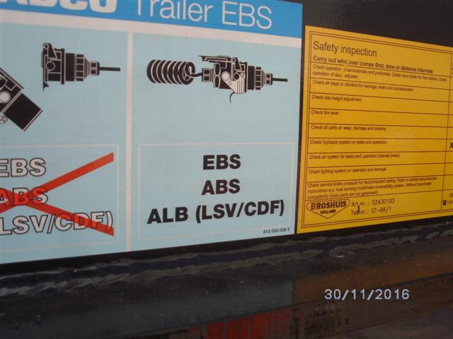

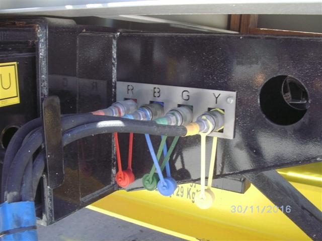

Pictures from a so called "power trailer" (loaded in USA but maybe European technology). When the different trailers are assembled, including the control room, you have a power plant that can be removed at any time to a different place.
My questions:
What this graphic / acronyms mean?
Video signal? Optical fiber?
A happy half hour of googling reveals:
EBS = Electronic Braking System An abs type system for transport trailers.
LSV = Load Sensing Valve
ALB = LSV in German
The pictures mean that when the connectors are un-mated this lot will not work and when mated it will work.
A link to lots of info about trailer braking systems.
https://inform.wabco-auto.com/intl/en/informindex.php?group=5000&family=29909&familyname=ALB (Load Sensing Valve)&suchwort=&max=10&level=1&name= Publications
Gracias Jim for your time. Lot of info really.
Besides the acronyms I am trying to make sense of the drawings (for what is it and for what it is not ). The coil shown after the actuator, is it an inductor, a tubing coil or...? Not intuitive except for insiders at Wabco, I guess.
