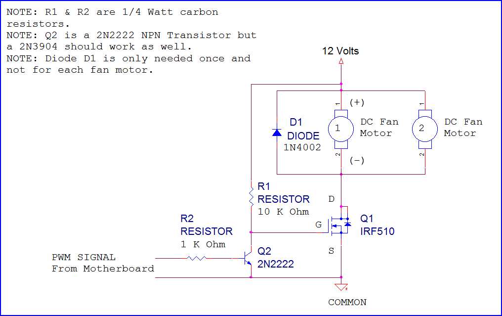

Attached is a circuit I played around with a few years ago that worked pretty well. Just a simple IFR 510 N channel MOSFET driven by a 2N2222. Using the IRF 510 MOSFET the thing could likely drive 20 fans.
A few other MOSFETS you may want to look into are what is called Logic Level MOSFETs or MOSFETS requiring a low gate level for turn on. The IRL 3202 and the IRL 3302 may be of some help to you.

thanks Ron, circuit helped me (who would have guesed that the load had to be in the drain side for it to work....) but the output signal is inverted...."NOT" function there
