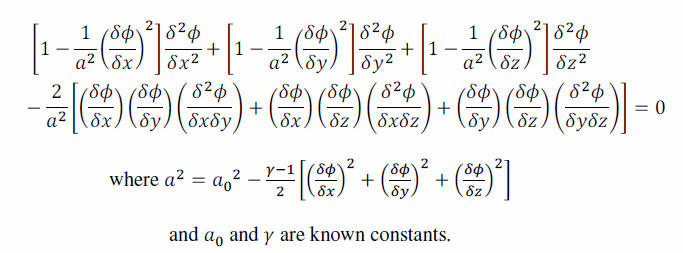

I'm hoping that someone could refer me to text books in advance calculus or PDEs. I have at least three brilliant maths text book, but all of them stop at elliptical, hyperbolical, Laplace and "conduction"-type PDE's. I am in need of finding methods to solve a non-linear PDE, preferably by transforming into a linear PDE (assuming I can transform the solution back into the original variables and/or time/space reference), or other strategies that may suit my particular need.
I know that this is the kind of stuff that Ph.D's are made of, but right now this is more of a hobby for me. The result could, however, forward my career in mechanical engineering as well, as soon as I find out how...

I'm trying to not use full spatial discretisation. BTW, some aerodynamic theory was based on electromagnetism, so as far as I'm concerned, math is math, right?

Actually, I forgot to mention that, as far as structural mechanics go, I don't mind full discretisation of each/all member(s), since their geometry is fully defined and everything else is (relatively) non-load bearing. But when it comes to fluid mechanics, I prefer boundary element discretisation over full spatial discretisation simply because they take less time and, should the structure deform due to the fluid dynamic loads, the changes to the boundary elements would be far fewer than the changes to discretised space, hence taking less time...
So, here is an example of an equation which I would love to solve using the boundary element method (BEM). Equations like this one serve as proof that we engineers are mathematically inapt, since we rely so heavily on (not necesserally the best) tools. This is why I'm looking for advanced mathematical tex books, or to study mathematics before pursuing further post-grad engineering.
Read it and weep.
Believe me, derivation of the above is no easy feat, unless you bypass pages and pages and pages of writing with that popular maths-statement "it can easily be shown that..."

Well it certainly looks like you have your work cut out for you :)
I wish you the best of luck, and if you find any useful equations for general electronics applications or even robotics or control theory i wouldnt mind taking a look.
