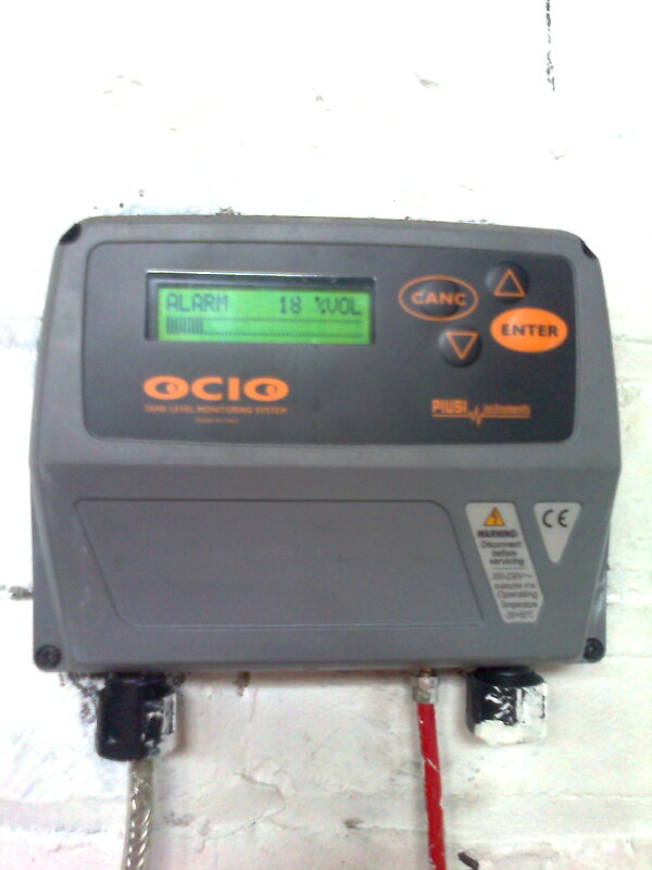

Here at work we have a oil heating system, I fitted a fuel guage to our outdoor tank.
The tank just has a nylon pipe inside it with a brass weight that holds in on the bottom (pipe goes in from the top breather hole).
In the guage there is a mini air compressor (fits in your hand), it compresses air untill it blows bubbles through the tank at which point the pressure doesnt go up any further, from this the guage tells you how much is in the tank.
The only thing the guage needs to be set up with is the density of the fuel at a known temp.
You could build one of these or buy one, I'll go and look at the manufacturer of the guage if you like.

Dr Pepper, if you could get some information about the manafacturer of those gauges that would be great.
Thanks everyone.
No probs.
Its a PIUSI instruments, this one is fitted to a 50,000 litre tank, probably a little bigger than yours I presume, the same company do them right down to portable equipment tanks.
Good job I looked, we need some more juice before winter.
