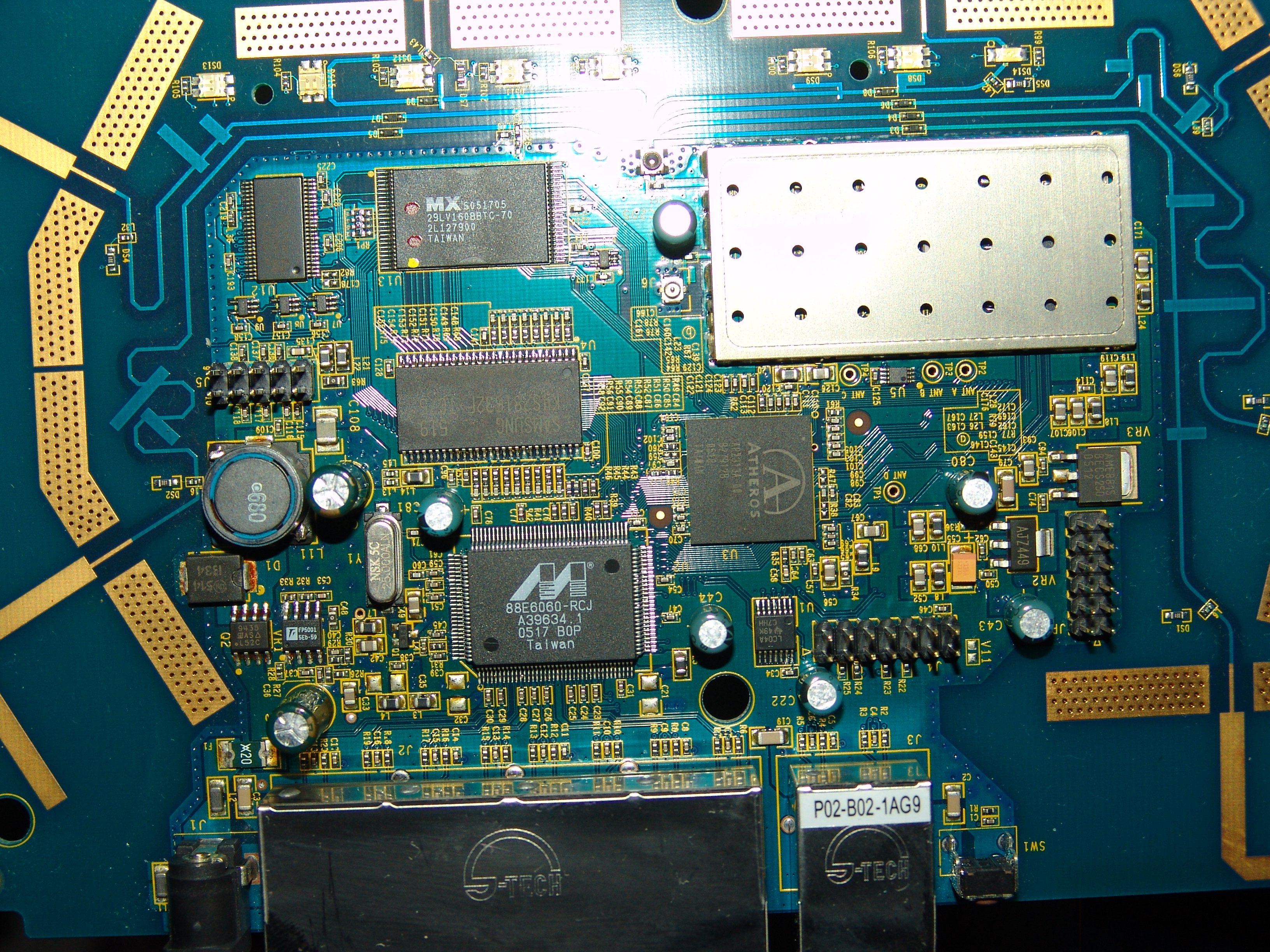

The second router is much trickier since it is the on board power supply that was damaged (meaning, I can't just swap it). The symptoms are similar, everything is fine until a certain load (in this case, when the wireless module starts), then the power becomes unstable and the router locks up and supposedly the onboard watchdog resets it. One additional symptom however is that there appears to be a hissing sound coming from a inductor when the power beomes unstable (I can see the power light flickering according to the hissing).
Preliminary tests show that:

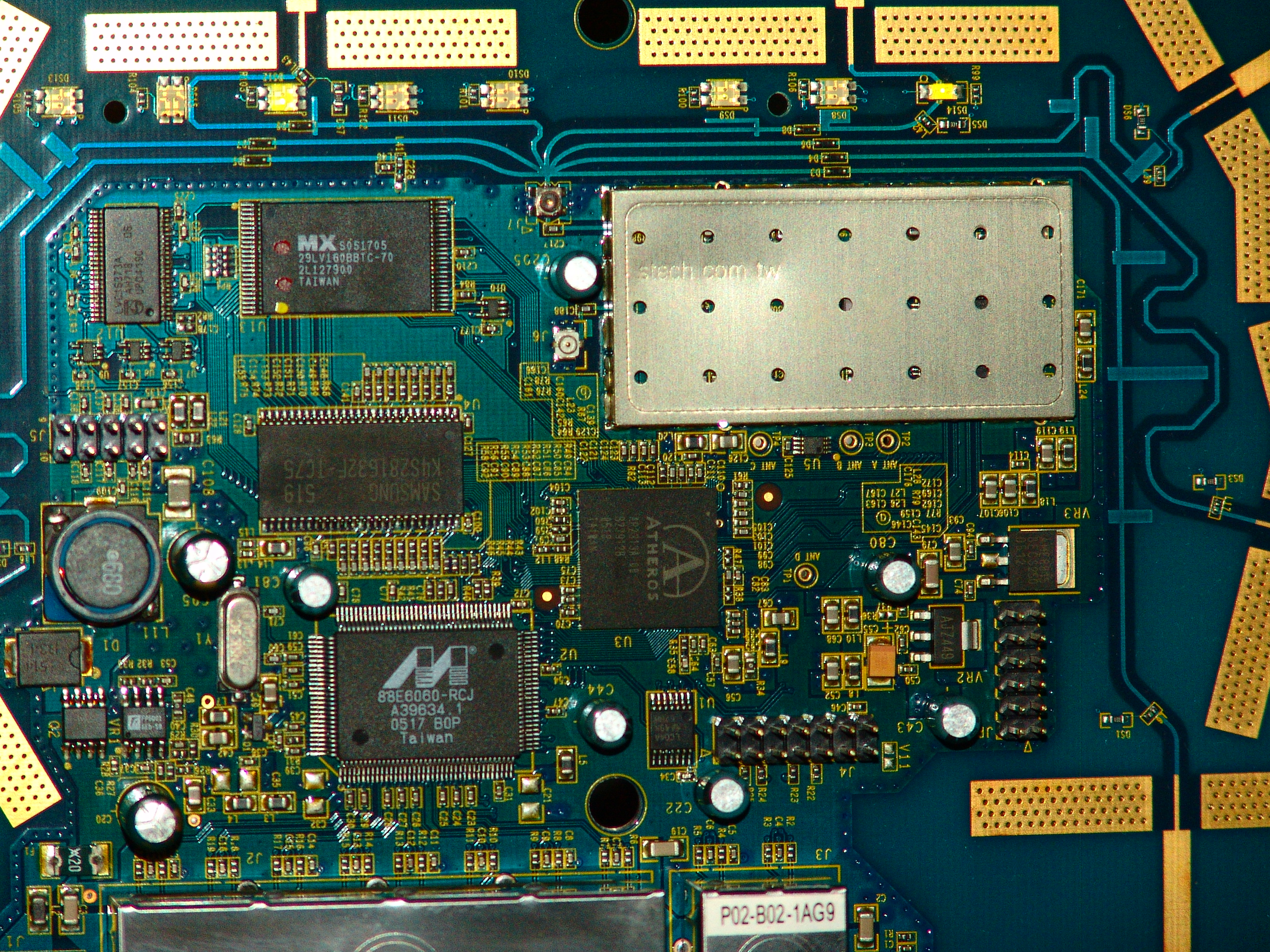

1. Input and output electrolytic filter capacitors (C20 and C95, maybe C8) are not shorted nor open and resistance slowly goes up to infinity when charging, but I don't have a capacitor mode on my DMM nor can I measure their ESRs. C20 has a mild bulge though. (I also can't determine if the caps are fully functioning well or just fails under load)
2. The polyfuse F1 seems to be working properly and does not trip when the router is turned on or when the power becomes unstable.
3. The voltage regulator (VR1) provides a ~12+-1V output, within its specification's limits.
4. The unknown diode (D1) (by DN? Model 514?) seems suspicious as I can measure a voltage drop in either direction with the diode mode on my DMM. The forward voltage drop is about 0.115V, and 0.794V when measured the other way round.
5. The inductor coil at L11 is the source of the hissing sound. I don't have any tools available for inductance testing but I know the terminals at both corners measure close to 3.0V with respect to ground.
6. There are two more voltage regulators (VR2 and VR3) on the other end of the board, both seem to be working properly.
7. Q2 is (I think) a PMOSFET. I don't have the necessary time to test it, but I guess it can be a cause too.
8. I don't think there is any unusual heat generated. Most of the heat comes from the Atheros controller and the ethernet switch.
With the information above, my question to all is:
1. Why did all this happen? Did I really experience a power problem?
2. What is wrong with the power supply of the second router, how do I fix it?
The wall wart of the second router is DC 12V 1A, pin positive.
Below are photos of the circuit board of the second router.

The cap with a bulge is very suspect. Replace it and the issue is likely solved. It probably has high ESR now, and under load will not perform properly, resulting in voltage fluctuation "noise" on the DC supply output. This is causing the extra mechanical noise from the coil.

The wall wart provides a basic suppply voltage, the internal supply in the router does final regulation, along with any secondary voltages needed. If the wall wart cannot provide a solid supply because of a weak capacitor, the internal supply will not be able to do its job. If the internal supply has been damaged, even a clean wall wart will not help, since the internal capacitor in the router cannot hold a DC level.
D1 likely has other components accros it that will give you a misleading measurement. Unless you remove it, you cannot trust an in-circuit reading without knowing waht other circuitry is connected.
Hmm, it is the capacitor alright! The input filter capacitor's bad.
I'm having a problem replacing it though. I guess the manufacturer used solder with a higher melting point than my iron can handle. It refuses to melt even though the iron has no problem melting the solder I use. I'm currently attaching the replacement capacitor in parallel with my own solder.

Hmm, I managed to remove the old capacitor and (barely, hole became very small, I could not totally remove the solder) replaced it with the new one using Nigel's suggestion.
The router is now working very well! Thanks to all!
(I might not have noticed the offending capacitor if not for another same capacitor on the board. The bulge was so small that it seemed normal.)
