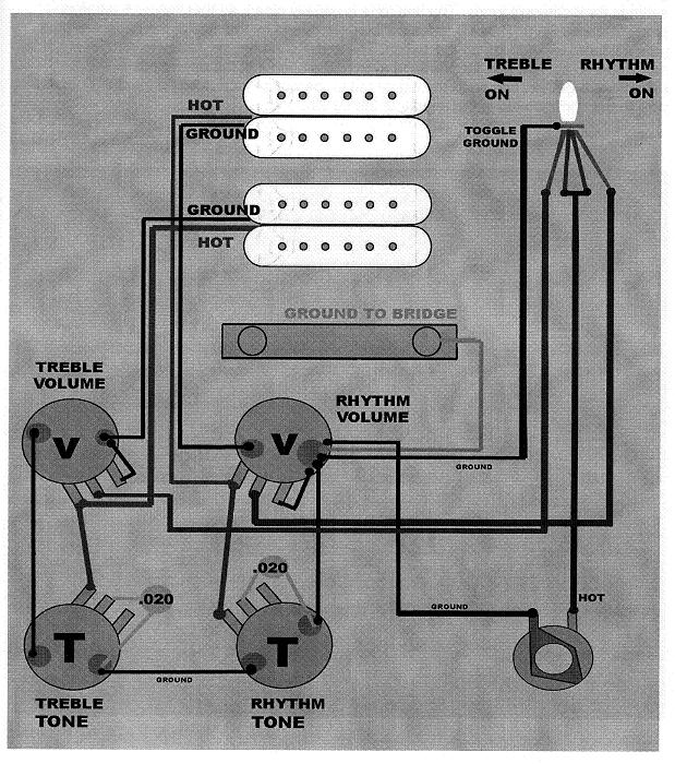

I handcraft electric guitars & ever since we have moved to a new location I have a noise issue with the guitars.
Not sure what sort of noise it is called white, pink etc, just a fuzz type of sound that disapears when you touch the strings or the controls, pickups etc or any metal cover parts.
The bridge is earthed & all the control pots are earthed on the back, I have copper shielding tape under the pickups & in the control cavity with an earth wire to the shielding.
This noise is amplified when using any effects with gain & is an issue, with some amps you here it more than others & not at all in some. It's not noticable when playing the guitar as you are touching it.
Any idea's how I can eliminate this noise?
I have included a wiring diagram very simillar to what I use.
My control covers & output jack plates are metal but I don't have an earth wire to these?
Cheers
Add an earth wire to those also. Many times the source of the noise is fluorescent tubes. Maybe the lighting in your new place is different? Guitar strings act like antenna picking up the noise. Make sure your strings are properly grounded.

I'll try it, although I thought they would be grounded by the control pots & the non isolated output jack?

The bridge should be grounded(!) and the pots bodies.

I found the problem this morning, we have a wireless router for the internet, I had this turned off this morning while testing a guitar & the noise issue was gone.
When I turned back on the static noise was back, need to throw the wireless router out the window.
