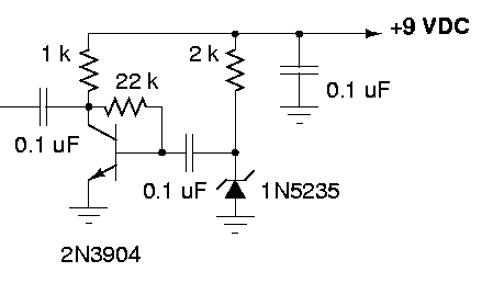

can someone explain to me how this circuit generates noise??[/img]

A zener diode is noisy. A Google search on zener diode noise may turn up some info on it. I have used a circuit like this to check CB radios (11 mHz), so the frequency is wide band.
Some diodes are more noisy than others, some are even designed specifically to generate noise. This is quite a common technique.

Zeners are EXTREMELY noisy, you would normally fit a capacitor across them to reduce it, many circuits for noise generators use this type of circuit.

but still one thing .... what about the 22k resistor does it have anything to do with the noise generating or just a feed back

It's the base bias resistor for the transistor, it also provides a degree of both AC and DC negative feedback - this allows you not to have to select the resistor value for the particular specimen of transistor you use. However, it does reduce the gain of the amplifier, due to the AC feedback.

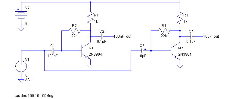

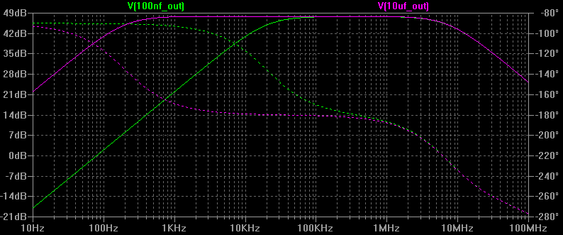

The gain is reduced if the source impedance is significant. However, since the source impedance is only a few ohms, the mid-band gain is actually not affected much by the feedback resistor. What IS affected is the bandwidth (low frequency corner). The feedback lowers the input resistance. Simulation shows the low frequency corner to be about 16kHz! Not very useful if you want audio noise. The input cap needs to be increased to at least 10uF if audio noise is desired.

The 0.1uF input cap, in conjunction with the input resistance of the amplifier, form a highpass filter. See the plots below. I show what happens if you change the input cap to 10uF.
The transistor has no purpose other than amplification. If you follow it with an op amp as a linear amplifier (not as a comparator, or limiter), you may not need the transistor. However, eliminating the transistor amplifier will mean you have to run the op amp at about 100 times as much gain in order to get the same signal level. This will lower the high frequency bandwidth by the same ratio.
