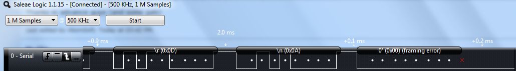

Im trying to write a ROM string out to UART at high speed (even at low speed same results)
My Speed is 115.2kbps (using a 14.7456MHz Crystal)
NO PLL ...
rom char welcome[23] = "AtomSoftTech Hey\xD\xA";
//... Init UART
init_uart();
//...SEND ROM STRING
UartRomStr(welcome);

The code works as i get the message on my terminal but it does not create a Line Feed...
I tried:
\n\r --------and-------\r\n
\xA\xD --------and-------\xD\xA
ALSO TRIED:
welcome[]....
NO LUCK! You think its my terminal ? Im using Putty (0.62) (windows 7)
Thanks in advance guys (and some gals)
Ok i got it to work like:
rom char welcome[] = "AtomSoftTech Hey\r\n \0";
EDIT: Fixed
rom char welcome[24] = "AtomSoftTech Hey\r\n\0";
