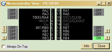

And Proteus Project, which I attached and the problem is that when I connect 5V to RB6 (accelerate), motor accelerates constantly but when I connect 5V to rb5(Decelerate), motor stops running imediatelly and I can't understand why.

RB5 is set as an Output,????

I downloaded your project file but could not open it to see the schematic so -
Do RB5 and RB6 have a pullup resistor on them?
What type of switch are you using to trigger RB5 and RB6 (i.e. Normally Open Momentary, Normally Closed Momentary, or a Latching switch)?
As was said before...you need to configure RB5 as an input as it is currently set up as an output. Once you can answer my questions regarding the pullup resistors and the accel/decel switches we can assist you further.
The problem was that RB5 was output :D
