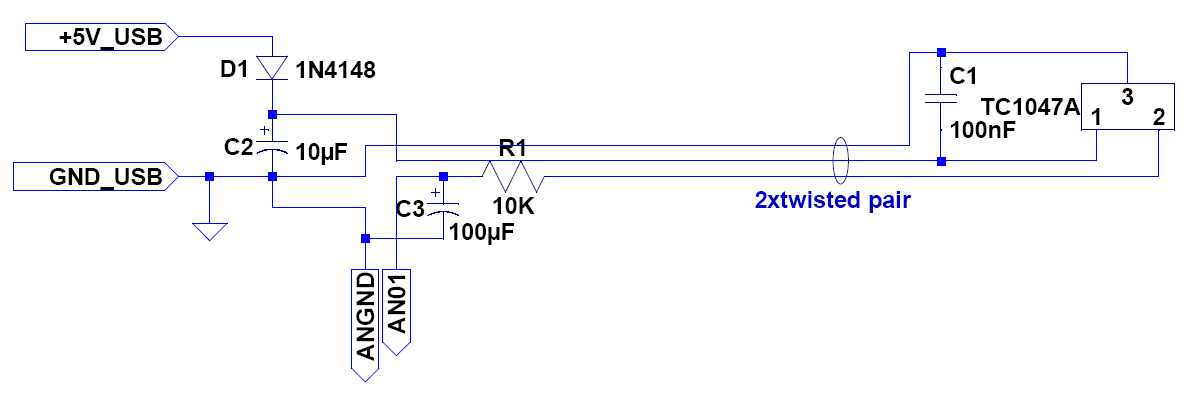

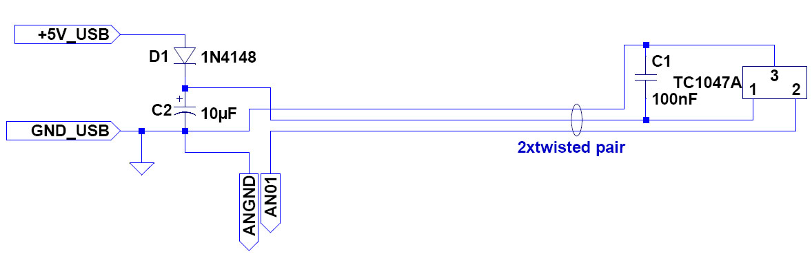

I'm using a temperature sensor the TC1047A in my project. As A/D Convertor I'm using the H-Tronic HB628 board.
The circuit design as attached (see TC1047A) I "stole" form the documentation of the board. Although the sensor should be calibrated within 1 degree celsius, this doesn't appear to be working in my application. Besides the output not being accurate the output is also fluctuating quite a bit.
The +5V power is derived from a USB laptop connection through the HB628 board.

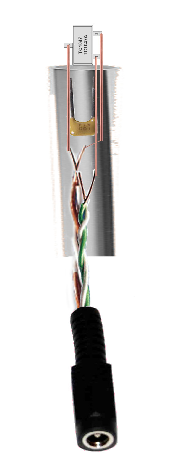

The distance between the sensor and my experimental board is approx. 50cm and the sensor is connected by 2x a twisted-pair. The last bit to the sensor with "winding-copper", (difficult to solder), since the device is actually an SMD device. See ConnetionSensor for a schematic lay-out how I build this connection. I'm using a mini-jack female at the end that connects to the male variant that goes with 2xtwisted pair again to the experimental-print-board that connects throught a flat-cable to the HB628 board.
I guess the diode is not really necessay, since the original design is using a TC1047 [without the A], which accepts lower-input voltage than the A version. Or does it serve another purpose?

You have Vdd and Vss reversed. The part is likely toast.
@MikeMl:
You scared me, and thus I re-checked the connections and data-sheet:
pin 3 = ground
pin 1 = supply voltage
pin 2 = output
The circuit is working only not accurate.

According to this **broken link removed** (page 6) you could try adding an RC filter at the sensor output to filter any noise (probably 60Hz). Make the RC of the filter as large as possible, based upon how often you need to take a reading.

I would use something like 10k and 100µF (negative to ground) which gives a 1s time-constant for a 0.16Hz low-pass filter (about a 50dB reduction for 50Hz interference). How rapidly does the temperature change, and how often do you take a measurement?

A too hasty applaud.....
Guys,
I'm sorry my hurray was I guess too hasty since I was so thrilled it worked.
I've adjusted the circuit according to the attachment.
Now the issue seems to be when the temperature goes up the readings are ok, and it doesn't fluctuate anymore, that's the good news.
However when the temerature goes down it takes ages before I get the right reading.
I guess the capacitor has nowhere to dechange, right [need to show you guys that I have a very tiny bit of knowledge I guess]? Would a parallel resistor to ground do the trick? If so, what value should I apply, if not any other good suggestion?
Martin

Try reducing the filter cap to ~1uF. The buffer opamp inside the sensor may not like driving the huge capacitive load presented by 100uF.
The capacitor does discharge through the resistor to the temp sensor output amp (the amp can source or sink 100µA) so the settling time should be the same going either high or low. As I mentioned, the filter has a 1s time-constant so it should take about 7s to be within 0.1% of a new value. If that's too slow than you can either reduce the value of the resistor or the capacitor. Of course that does reduce noise rejection also, but hopefully you can find a compromise value that gives adequate rejection with acceptable settling time.

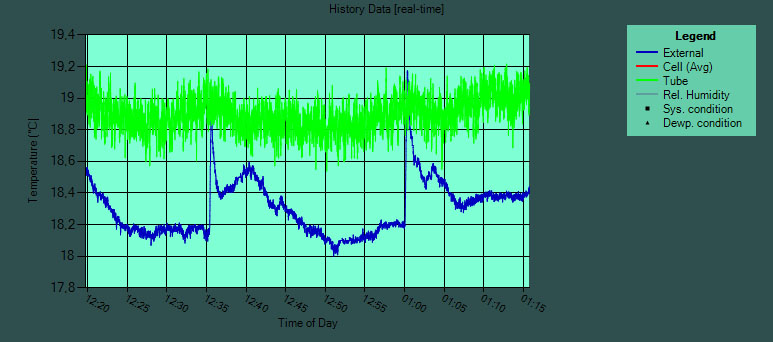

Good news, all works fine, just wanted to share some measurements with you, and a few [minor] open ends.
Please have a look at first attachment. This really looks cool and OK.
The green-line is a temp.sensor without the RC-circuit, and the blue-line with the RC-circuit installed on the board.
At around 12:35 and at 13:00 I give the sensor a kick to see how it responds.
One strange thing, I'm not so bothered about, but I'm curious anyway: look how after the kick the temperature drops, raises again, drops, raises and undershoots to finally reach it's end-value. I should probably ask a thermodinamic expert, but does anyone have a clue to why this is?

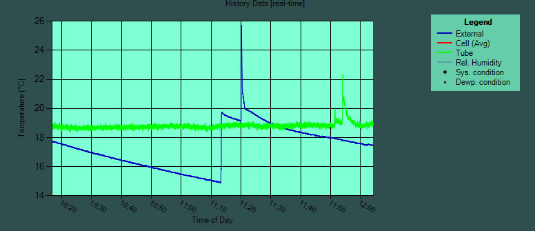

If you look at the second file, that's where the sensor has a loose contact. Blue line starts at around 18 degrees, drops to 15. I start fidling a bit on the wires, correct value comes up, starts dropping again at around 11:15, I heat up the sensor, nothing happens, fidling with the wires and the correct value comes up again and starts dropping. Now I suspect that at the point where the value starts dropping in an almost liniar way, this is because the capacitor unload via the 10M resistance in the A/D-cicruit, correct? And the tiny spikes in the values are the result of the inaccuracy of the A/D-convertor [it's a 12-bits, from 0mV-4096mV obviously in steps of 1mV, with an accuracy of 2mV, I guess it's actual accuracy is therefore 11-bits, or looking at the graph perhaps even 10-bits].
If anyone can/want to do the math for the decharge of the cap.:
So at 10:20 temp is around 17.8 degrees celsius ~ 678 mV
So at 10:50 temp is around 16.0 degrees celsius ~ 660 mV
Not really needed, just curious if it figures...
