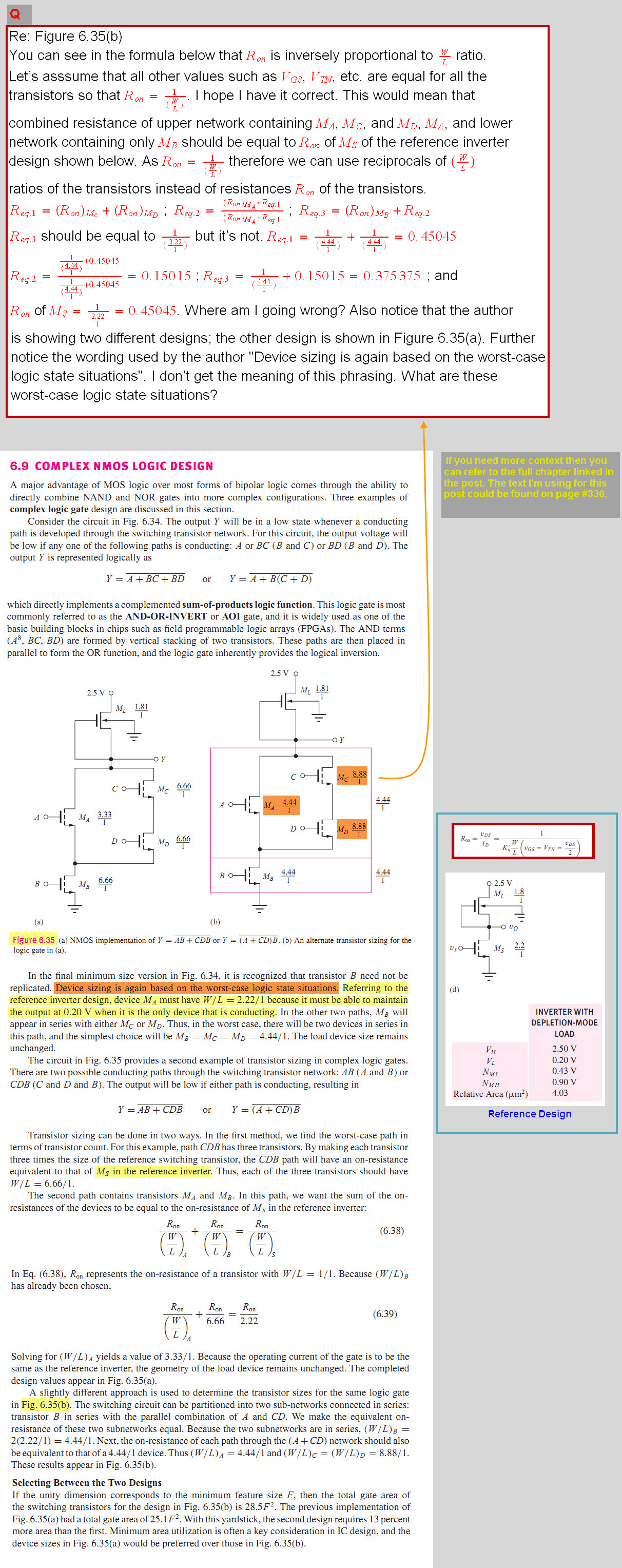

Hi
Could you please help me with this query? You can see the complete chapter here. In the attachment I'm referring to the chapter's page number not that of PDF file's page number. Thank you.
PS: The author kind of elaborates on what he really means by "worst-case logic state situations" in second-to-last paragraph on page #325. Example #6.9 on page #331 is also useful where the author says "and transistor sizing will follow the worst-case path approach".

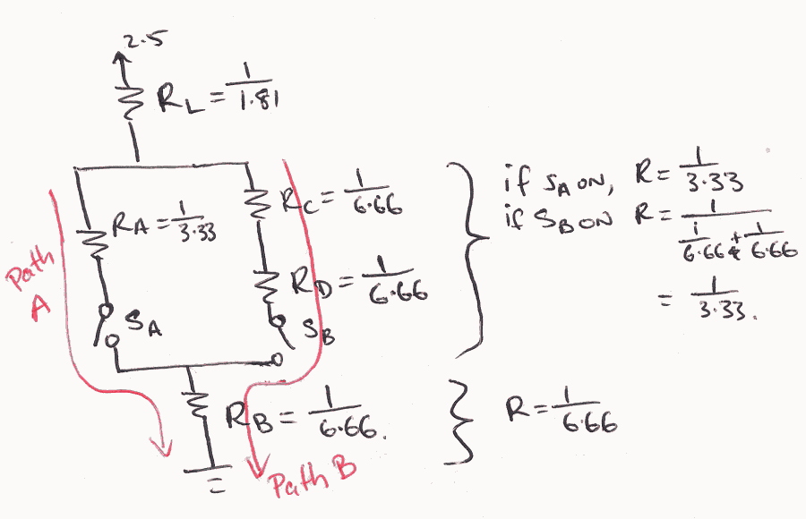

Well, you've stated that Ron = L/W so all calculations are simply those used for resistors.
There are two current paths to ground from Y. One through A & B, and the other through C & D & B. The worst case resistance to ground is when only one of these current paths are conducting.
If both current paths are conducting, then the resistance to ground will be reduced and is obviously not worst case.
You simply have to find some values for L/W that allow the total resistance from Y to ground to be 1/2.22 (assuming as you wrote Ron = L/W).
Referring to the left diagram, if the path A&B is formed, the resistance from Y to ground is Rab = 1/3.33 + 1/6.66 = 0.45... the W/L value is 1/0.45 = 2.22, which is what was asked for.
If path C&D&B is formed, the W/L from Y to ground is 1/Rcdb = 1/(1/6.66 + 1/6.66 + 1/6.66) = 2.22, which is also the value you're after.
The same goes for the values in the figure to the right. 1/(1/4.44 + 1/4.44) = 2.22 = 1/(1/8.88 + 1/8.88 + 1/4.44) = 2.22

Thank you, Doug.
I think in this example being discussed, the W/L ratios have been found keeping in mind the worst case scenario. The resistance of the path CDB is equivalent to the resistance of reference design; and same is true for the other path AB. Previously I had thought that combined resistance of all the transistors should be equal to that of the reference design.
You said, "If both current paths are conducting, then the resistance to ground will be reduced and is obviously not worst case." Why would it be worst case when only one path is conducting and the voltage increases? Could you please elaborate on it? Thanks.
