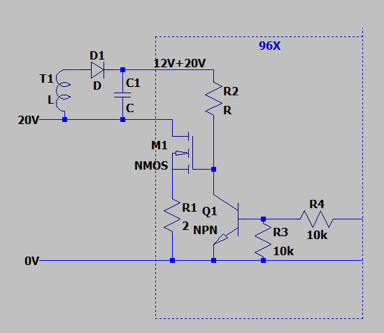

MAX845 is a option. Do you have 5V to 3V to run it? With the right transformer you could make a +12V supply that sits on top of you main supply. If you don't have 5V for the MAX845 I know of a part that will do 30 volts. LT3999.
Q1, R3, R4 = one part. "Digital transistor"

I like the circuit ronsimpson showed in post #4. That will give you independent control of each channel with only a single isolated power supply. And, if the input voltage is stable, you can use a boost converter to make the high side gate voltage instead of an isolated supply.
Be aware:
1) The enable signal is inverted. A high in R4 will turn the channel OFF. A low on R4 will turn the channel ON. This means that, assuming that you don't want all 96 channels to be ON at system power up, you need to ensure that all Q1s are ON at power up. This can be done by connecting R3 to +5 instead of GND.
2) The turn OFF time will be fast. The turn ON time will be slower as the mosfet gate gets charged through R2.
Edit. Corrected a mistake in this post, See post 11 below.
Back in post #9, I said that the gate drive voltage could be generated by a boost converter. That is incorrect. The gate drive voltage does need to be floating and referenced to the positive power rail as shown in post 4.
