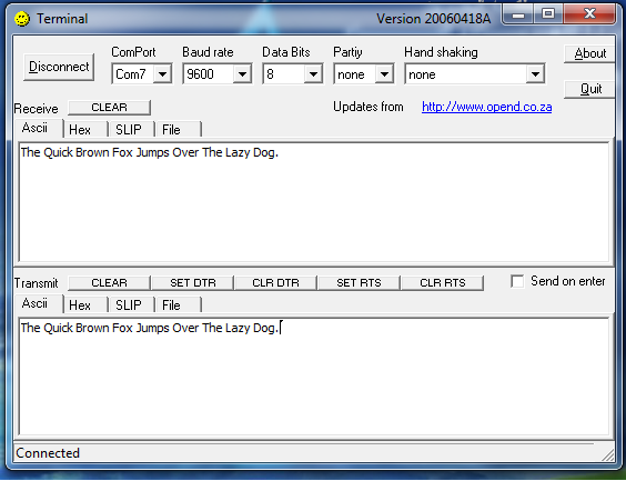

Thnks for all, Ive found several alternatives, used them and have no response, only getting "0x00" which indicates no data recived. I've used N.G. first circuit in
. Is that fine or shall I use the second circuit in the same page?
Thanks Nigel,
I was much worried about the MAX 232 connection because I've read some where that it has two converters, one software and the other hardware, so that I thought I'm using the wrong one.:confused:
One step on the right way achieved, My PIC (16F628A) got connected into my PC (windows7), using very light software called Terminal the attachment shows a screen shot of sent and received data using the underneath code found in Mikro C help for USART.

unsigned short i;
void main() {
// Initialize USART module (8 bit, 9600 baud rate, no parity bit..)
Usart_Init(9600);
do {
if (Usart_Data_Ready()) { // If data is received
i = Usart_Read(); // Read the received data
Usart_Write(i); // Send data via USART
} while (1);
