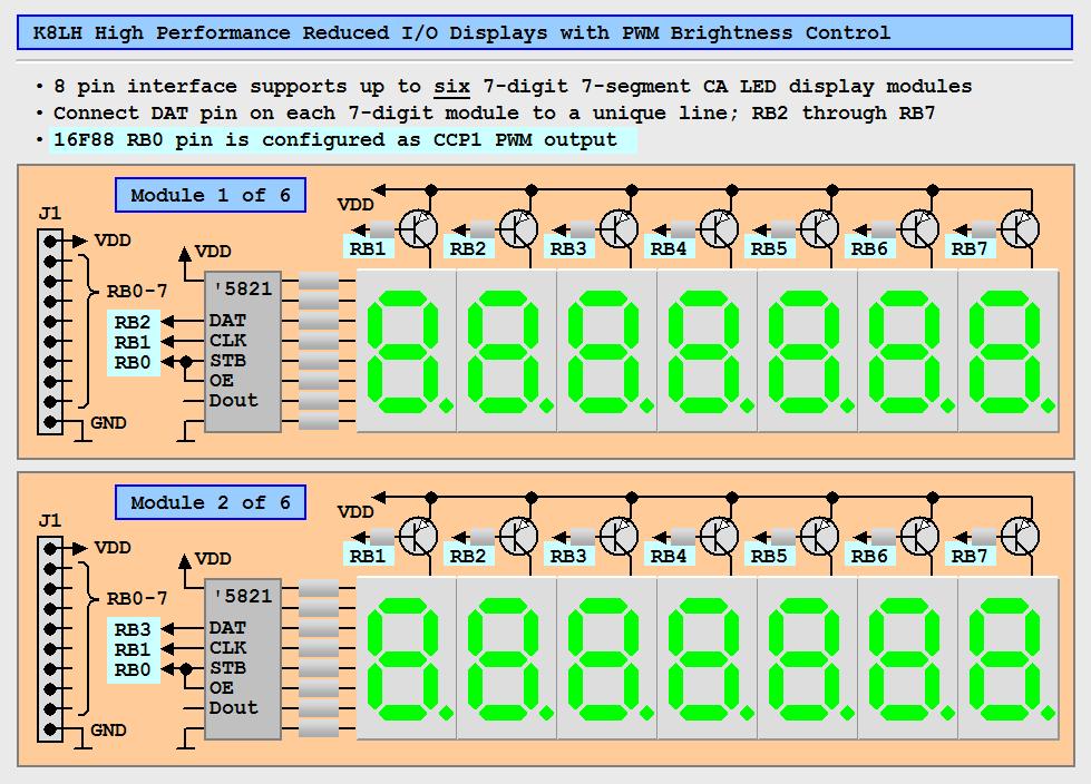

I was thinking of proposing such a kit to you Bill. I was thinking of multiple display footprints; three staggered dual-digit patterns for Clocks and one normal 8-digit pattern for Frequency Counters or such. Use single in-line sockets and you could easily reconfigure the displays for either footprint. And you definately need a column of discrete LEDs just to show what you're lookin' at after pressing the <Mode> switch; Clock, Calendar, Alarm, Appliance Timer, Indoor Temp', Outdoor Temp', Frequency Counter, etc.
Anyway, let's see the schematic, please? And I hope you don't mind if I make some significant suggestions, like losing the 4017 in favor of an MIC5821, and others, to provide a truely "high performance" design.

You'll never get full brightness by directly driving segments from PIC pins when you have more than a few displays. The duty cycle is just too low and the PIC pins cannot provide the necessary 'peak' current. You could always add transistor segment drivers but then you have 1 driver IC, 6 column driver transistors, and 8 segment driver transistors, so you end up using more hardware than you really need.

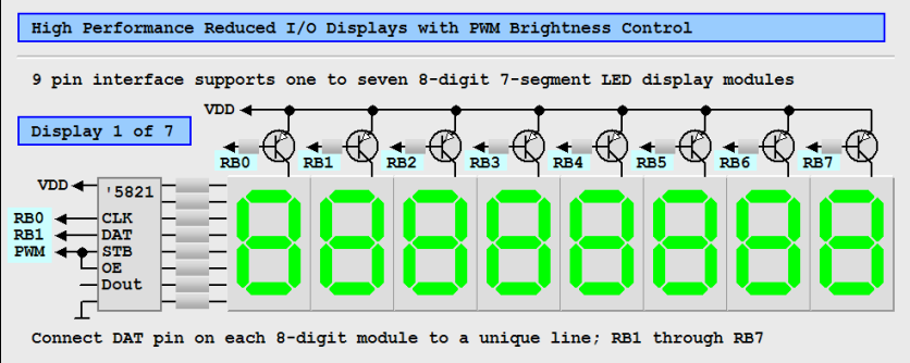

You're using 8 pins to drive the segments and two pins for the '4017. That's one more pin than my high-performance 9-pin design. I hadn't considered price of the MIC5821 IC before because I've been using pin-for-pin compatible Allegro A6821 samples.

I do like your idea of daisy chaining the displays plus your A6821 design looks top notch, and driving both cathode & anodes will get the brightness up for sure. I even considered Charliplexing but wanted this to be simple to grasp and difficult to damage with even with poor coding.

I use the MIC5821 or A6821 for CA displays Bill. Discrete LEDs can be used in place of one of the normal 7-segment displays in the matrix.

I see DigiKey sells the MIC5821 for $2.90 (USD) and the equivalent A6821 for $2.25 (USD). That is a bit expensive but if I were going to the expense of making a printed circuit board I think it would be relatively easy to justify a $2.25 IC over a $0.16 IC when you consider that you'd end up with a high performance full brightness display with full fade-to-black PWM brightness control using a 9 pin bus (that will support up to 56 displays or 448 LEDs, see below).

The johnson counter in the CD4022 is idiot proof as only one digit can be lit at any given moment; the MIC5821 can allow all digits to be lit as it's a serial to parallel chip, it is a cool chip though. At 1/6 duty HE RED MAN6940 displays appear plenty bright with a segment drive of 25ma x 7 (plus the dp)
Using the 4022 is a snap too, simply reset (blank display) and increment the clock for each digit and pushbutton. After six digits repeat. The CD4022 is still a popular IC, digikey has thousands of em (and so do all the local electronics retailers)
