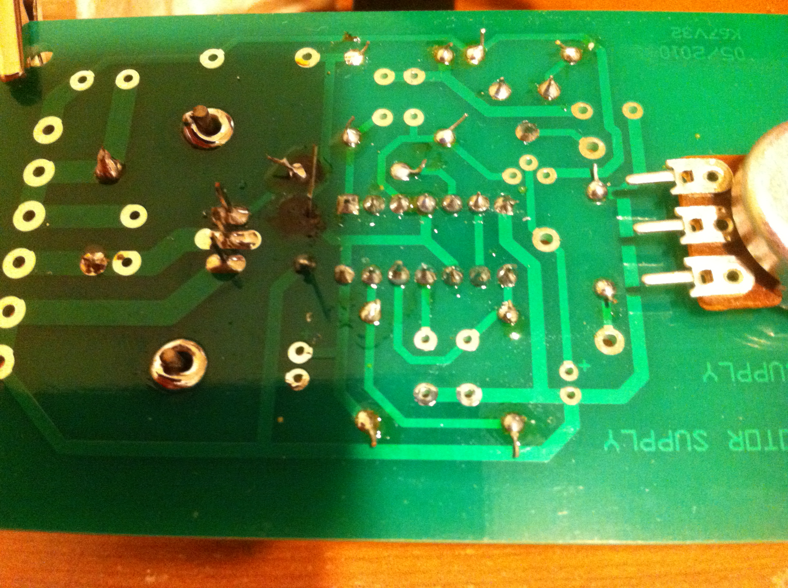

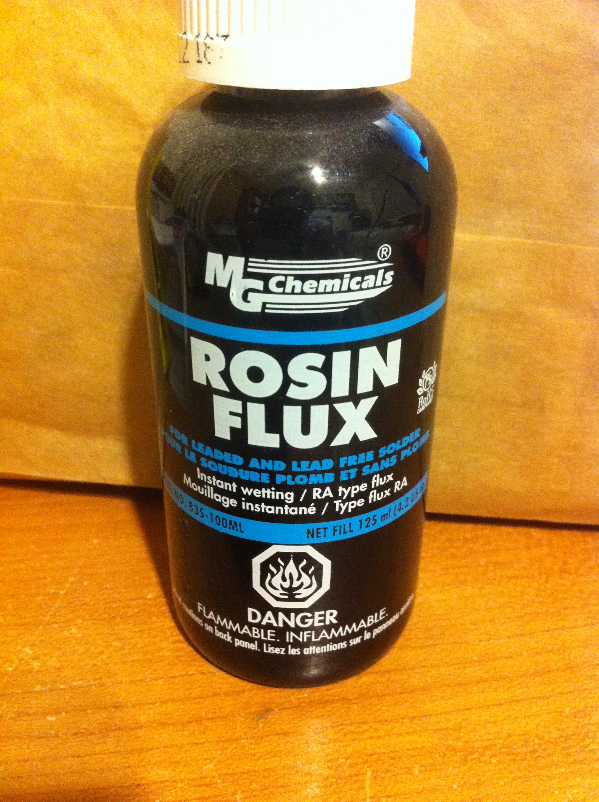

I had a newbie question regarding soldering. The picture shows this one attempt I made to solder and it left a black layer over the pad that I could not remove. Also, I will often have black residue left on my iron. Am I using the wrong type of flux or something? Do I need a flux cleaner?
Any advice? I don't know why soldering is such a pain!

Yes, you are using the wrong type of flux.
The flux in your picture is type RA (Rosin Activated) is corrosive and not suitable for electronic work.
If you must use separate flux, use RMA (Rosin Mildly Activated) type.
For the type of joints that you are making there, I have never used additional flux, I simply rely on the flux which is in the solder.

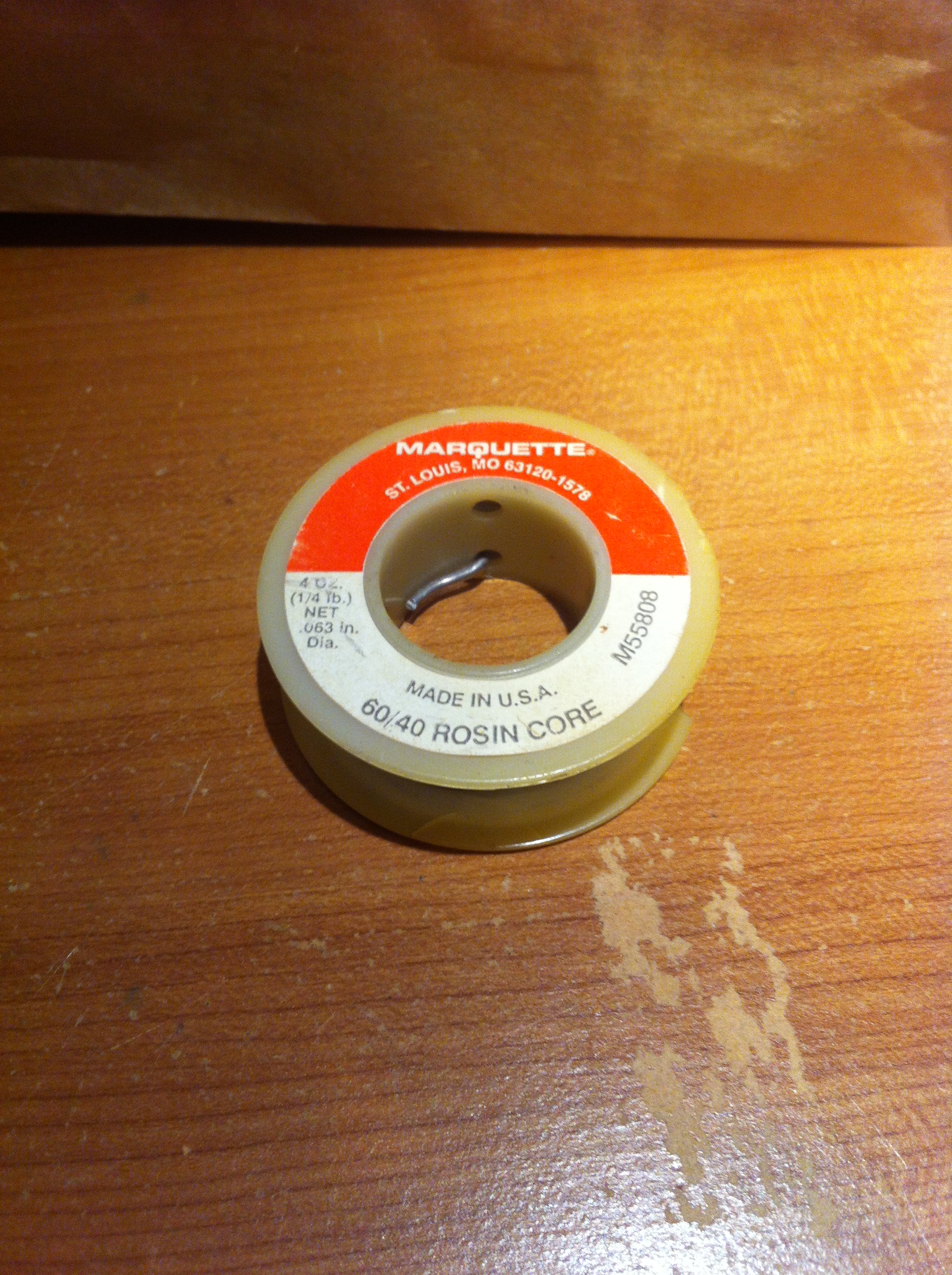

While on the subject of solder, what type are you using?
For hobby use, 60/40 or 63/37 tin/lead solder is best.

Judging form this joint:
I see shiny solder (good). As for the question about the lack area, I don't think it is from the flux. I think it is simply burned solder mask (i.e., the green coating) or burned conformal coating applied after soldering. Since it is charring, the only way to remove it is mechanical. A little alcohol on a Q-Tip may help at this point. In the future, you can try to scrape away a small area before soldering. Lacquer thinner on a Q-Tip to clean the area before soldering may also help. Also, applying a little less heat with a smaller tipped iron may help.

I don't think flux is your problem. You seem to be scorching the board, lifting pads and burning a lot of flux. These are all signs of a soldering iron that's not hot enough and bad technique. When the iron is not hot enough to heat the entire joint quickly to soldering temperature, you end up holding the iron on the joint longer to compensate and this creates the symptoms seen.

Thank you everyone for the advice. I usually use cheap soldering irons that cost five or six dollars. First, I had issues with my soldering tips always corroding and so I bought this flux thinking that would help. I then realized I am using cheap soldering irons, so yesterday I got in the mail this Weller WLC100 and tried to use it. My attempt to use it resulted in the picture you guys see above. What do you think of this soldering iron audioguru?
Below is a picture of the solder that I use.
Ok, so I need to get RMA type flux. Should I get rid of this RA flux? Should I get a flux cleaner to clean my boards, tips, etc?
Also, how do I fix those connections on the board? Especially the lower black looking one, solder will not stick to the pad, no matter what I do. How do I fix that? Flux cleaner? I guess I had the soldering iron too hot like jpanhalt said.

There are two types of black on your board. One is the charred PCB. There is nothing you can do to unchar it. You can scrape it away.
The second is the copper oxide on the copper caused by overheating. That can be removed with acidic cleaners (not recommended) or with fine abrasive. 3M green or maroon non-metallic abrasive pads should work fine. Other brands should work too. Once the pad is cleaned, tin it, then solder. It will be a little easier if it is pre-tinned.

It is not "name brand" Kester and does not say it is good for electronics. My solder is rosin core Kester 63/37, not 60/40.
No, you don't need any extra flux, you need the correct solder.
The solder you have appears to be a general purpose solder, the solder wire diameter is quite large 0.063" is 1.5mm, my thickest solder is 0.7mm and is intended for electronic use.
You need new solder and you do not need flux.
Buy the correct solder and the correct flux will be in the solder.
As for the RA flux and the solder you have already, save it for fixing something big and heavy like a water pipe.

I will turn down the heat on my iron next time then. As for the board, I will try to scrape away some of the black substance to see if I can get a reliable joint. If not, I will take off all the components from the board and maybe try perfboard or something.
I didn't realize the diameter of the solder mattered. I will do some more researching on different solders...
A thin solder gives you better control, helps to prevent big blobs of too much solder on the joint.
We are talking rosin core solder, not water based solder Flux. It's very different.
The 2 don't mix, can't use both, one or the other, once the water based Flux is clean from the board you can do Board Repair, but, you should then use chemical cleaner. Water based flux is cleaned with water.
But, Rosin Core is done with cleaner, water won't do any good in cleaning.

0.063 is at least 2x more diameter than you need, if not more. Honestly, 1/2 the pad diameter should suffice for the solder diameter.
