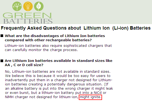

All semiconductor makers have Li-Ion battery charger ICs with very good accuracy. Linear Technology has one with 0.35% accuracy. They don't want the battery to burn.
Green Batteries have a FAQ about Li-Ion batteries:

The nokia battery (BL-5C) is a bare bones Li-ion, it has no protective supervisory circuit, if you fail to charge it right then you risk exploding batteries and the *very* nasty stuff inside them getting out.
