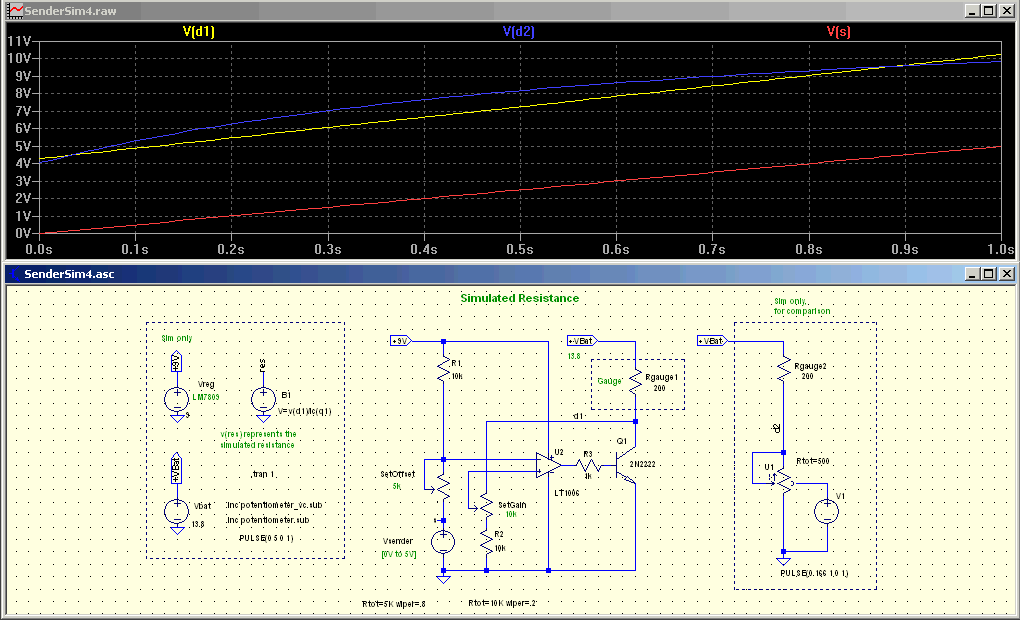

Let me start by saying I am totally new to circuit and small electronic building. This will be my first DIY type project, and Id like to be at Fry's tonight picking up stuff to play with.
The goal here is to control an OEM fuel gauge via a voltage signal. I have a pressure transducer, reading pressure and outputting a 0-5v signal. I need to build a device that can take that signal, and use it to control a variable resistor. The OEM gauge/computer looks for 50-300 ohms resistance in the fuel level circuit and uses that info to determine fuel level; 50 ohms is full and 4.5v is full. And 300 ohms is empty and 0.7v is empty. Im hoping the device can automatically scale everything in between. Can anyone point me in a good direction to start learning how to accomplish this?

I agree with Mike regarding non-linearities. But you can get an approximate simulated resistance like this :-
The yellow and blue curves show how the gauge input might vary respectively with a 0-5V control signal applied to the circuit and with a 50-300 Ohm sender change.
  • SenderSim4.asc

50-300 puts it in slightly wierd mode. The gauge wiring helps somewhat. It's important the get some V, I R (can be derived) and % Full scale data. Your meter could introduce 10 ohms or more into the circuit unless you use a zero resistance ammeter, It's also important to get the open circuit voltage.
Suppose for a moment that your guage went from 500 to 1000 ohms. An OPTO-FET, basically a LED shining on a FET which can vary the resistance from about 300 to 300 M ohms. So a computer could drive the LED until a certain voltage was across the FET which translates to a resistance.
The 50-200 ohms makes it more difficult to get there, but it's still possible. The point being, you would be able to "dial in" whatever "voltage you wanted" to appear across the "resistor". "resistor" in this case is not a simple resistor. Simulating ohms is hard, creating current and measuring the the resultant voltage is much easier and placing that in an analog feedback loop is MUCH easier.
Unless the transfer function was extremely simple, e.g. 1-5 V is 0 to 100% then it could be done analog. If it were 1-5 V is 100% to 0% that's more difficult.
A processor and a look-up table can work out the non-linearities.
From scratch, you might want to look at www.picaxe.com. The Arduino though is much more powerful platform. Interfacing is another hurdle. The I2C bus is a common way of interfacing chips to a processor.
You really do need the input to output transfer function and more importantly the transfer function of the current gauge.
