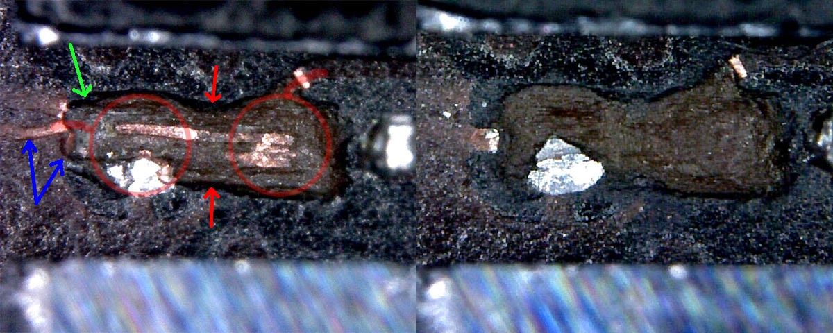

The phone didn't respond to touch. After inspecting the logic board, I found two blobs of solder causing shorts,
I found out the capacitor was missing after removing the first blob with an iron,

Hi, I knew iPhone logic boards are multi-layered, but what I discovered under the solder blob is actually 'above' the surface of the board though.
The last pic of the cleaned area might be giving the illusion that I burned a crater, but it's embossed.
I practiced removing a SMD capacitor on a spare PCB and did so without damaging the pads. I used more heat than I did on the logic board too.
I lightly scratched the surface of the werid embossed area and found it was copper. I was thinking that the pads are still there but someone has attempted to make a jumper across them from an previous repair.

Is the last image the same board as in post#7?
It looks, to me, like you have exposed copper from the layer below during the 'scratching' and folded a sliver over the top of the ground side of C137.
There are no pads left there, only a small piece of the left side of C137 pad, which now has copper from the next layer curled up at the edge.
Yep, definitely the same board. There are scratches on the IC next to C137 that identify it.
The thing about this exposed copper is, it's literally all above the board. It's impossible for it to be from the layer below due to this. The light scratch you see is one clean scratch. There's no sliver folding over. Thanks for the replies though. I'll start a thread about this when I get the bare 5c board from China which should be arriving soon. I need to cut into the C137 area to see what's underneath.

I have put your pics side by side for comparison. The right is the one before you started poking around and the left is the latest you provided.
The copper you are seeing in the crater created by you, is from another layer within the PCB.
How much you have been poking and removing PCB substrate can be seen from the red, blue and the green arrows I added to your image on the left.
The green arrow shows how much you have elongated the crater, the red arrows show how you have deepened the crater and the blue arrows show copper, which was not there on the original image, folded up from a lower layer and laid across the top of the PCB.
I don't think anyone else is likely to disagree with what I have shown.
Regards.
Thanks Mickster,
You are 100% correct! I'm glad I shared those pics. I was so convinced I was seeing an embossed area but it was indeed a crater. I honestly thought I was just lightly scratching and exposing a welded lump of copper that was placed above the board by a previous repair.
This is the illusion I was seeing. Copper already connecting the two traces over the board :facepalm:
I was viewing it with a perfect ring of LEDs around the microscope lens. After switching off the LEDs and viewing it with a light on either side, I saw exactly what you're seeing.
I also see the sliver you mentioned now casting shadow.

I'll fill the hole and make new pads. Then I intend to connect the pads to the traces with fine copper wire.
Trouble is, I've made a bit of a pigs ear out of the left trace as you can see. It was one silver looking trace before I started scratching lightly. It looks like 3 traces now, with one sliver pointing upwards.
