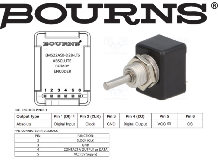

-Absolute Rotary Encoder Selection & Wiring: I chose a BOURNS EMS22A50-D28-LT6 Absolute Rotary Encoder. It has 6 Pins, most rotary encoders I have seen online are either a 4 for 5 pin. In my wiring diagram I only made 4 of the 6 connections, is this ok? It is my understanding that his particular rotary encoder does not have a center shaft "press in" button option but maybe I'm wrong, either way I don't need it. Here is a little feature on the encoder and the pinout along with what pins I connected.

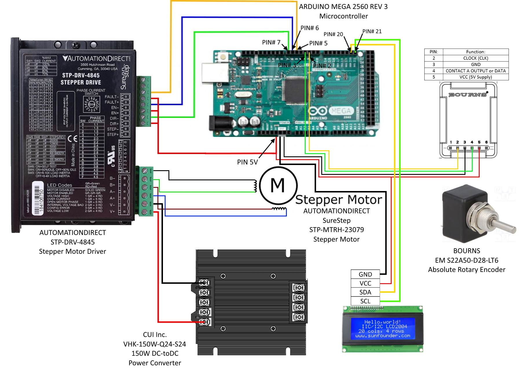

Here is a wiring diagram and component layout I made, looking for input on if I made the right connections.

If you are using that control valve, that motor will have the power to drive it from one end to the other in a fraction of a second, and I can't see why you need that. I would have expected a motor and gearbox arrangement, with a much smaller motor, and cheaper drive electronics.
If you do use that motor directly, the only reason to have the high voltage supply is to get the motor to turn quickly. In a stepper motor, the windings have inductance, and each step the motor takes, the current has to reverse in one winding, and the larger the supply voltage, the faster the current reverses. However, the resistance of the windings is small, so the voltage cannot be left connected to the motor, or the current would soon get too large, which would lead to the motor burning out. Once the current has reached the maximum value, the stepper motor controller will limit the current.
The motor you've got has a winding resistance of 0.4 Ohms and a maximum current of 5.6 A. So when the motor isn't moving, and the current isn't changing, you will only get 2.24 V across each winding. With a 12 V supply, you can get the maximum current from that motor without a booster, just you won't be able to get the motor to move as fast, but I still think that it will be very quick compared to manually adjusting the valve.
The stepper motor can go round as many times as you want it to. The absolute encode will tell you the angle, but won't tell you how many times round it has gone. For that you need something like a 10-turn potentiometer, but you would have to have some way to know where the start point is.
Many systems like this will just remember their positions when they turn off. You can save the position in the Arduino and the stepper motor won't move when turned off. You can also have an end stop, and just drive the motor to that and back each time the power is turned on. Lots of stepper motor applications do that.
About the 5 V pin, you can connect lots of things to one pin, but the total current must not exceed what it can supply. I'm not sure how you are intending to power the Arduino, so I don't know what the rating would be.

The enable pin on the stepper motor driver will take very little current. The encoder takes 20 mA max. I don't know how much current the LCD module takes, but it should be OK on the 200 mA supply, and it will probably just go dim if it tries to take too much.
You can get the Arduino board to count revolutions. You will need to store in non-volatile memory where it is for when the power goes off. You will need some way to set it to the right turn initially.

The encoder is a single-turn absolute type, not multiturn. That's fine if the rotation output you need to control is no more than 360' or you can gear down (eg. using a timing belt) the shaft rotation to the encoder, so the encoder never moves more than one full turn?
For multiple turns or higher resolution, you would need a multi-turn encoder or pot for feedback.

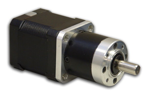

I have decided to go with a Anaheim Automation NEMA 17 Stepper Motor with a 51.06 Reduction Planetary Gearbox instead of the AutomationDirect SureStep NEMA 23. It is rated @ a 0.85A "Bipolar Current" (I believe this means 0.85A per phase). The AutomationDirect SureStep NEMA 23 had a "Current Rating" of 5.6A and a holding torque of 286 oz. in. or 1.49 ft. lbs. It was a stronger motor for sure but 5.6A is alot of current for most drivers and it was a little too big dimensions wise. The Anaheim Automation NEMA 17 Stepper Motor I have chosen has a "Rated Torque" of 278 oz. in. or 1.45 ft. lbs. & a "Max Torque" of 833 oz. in. or 4.34 ft. lbs. I'm not sure if these ratings are for the motor alone without the gearbox or not, most I have seen online are rated that way, motor only torque without gearbox so I'd assume the gearbox will add alot of torque. Even if it isn't, the rated torque of 1.45 ft. lbs. should be just about enough I'd imagine. Another plus of using a stepper motor with a planetary gearbox is that the motor con operate at a higher rpm and velocity, meaning less stress on the motor and operation that is more within the designed range.

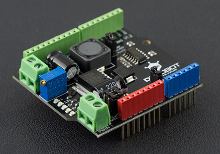

Also, I have finally found an ARDUINO compatible shield that I'd like to use. It's a DFRobot DFR0105 ARDUINO Compatible "Power Shield". Since I need a microcontroller controlled, 5V power source that can handle the current required to power the stepper motors incremental rotary encoder add on for feedback, the absolute rotary encoder input/adjustment switch, the LCD display & the AutomationDirect SureStep STP-DRV-4845 Microsteping Driver, this "Power Shield" will allow the ARDUINO Mega 2560 REV 3 board to switch and manage power at much higher voltages and currents than the ARDUINO board can do alone. The ARDUINO Mega 2560 REV 3 board's only 5V power output pin is limited to 5V & 200mA but with this shield I can use the board and control voltage outputs from 1.25V-12V & currents up to 2A (3A Peak). Since I am driving a NEMA 17 stepper motor and will be using a separate stepper motor driver to manage the power to the two phases of the motor, I don't need a ARDUNIO shield designed specifically for driving motors, I just need something that can manage power and deal with the voltages and current of running all the things I need to.

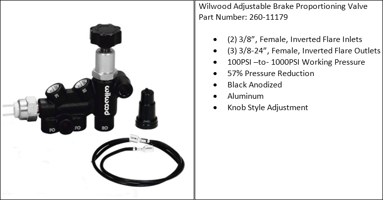

Here is the actual hydraulic, manual, brake bias adjustment valve i plan to use. It's a thumb screw adjustment type and has up to a 57% pressure reduction meaning I can easily achieve front/rear brake bias percentages between 70% Front/30% Rear or 70% Rear/30% Front (The most I'd likely set the bias to). I don't own the valve yet or have it in hand so I am uncertain of the resistance or torque required to turn the valve. I hope that the stepper motor's "Rated Torque" of 278 oz. in. or 1.45 ft. lbs. & a "Max Torque" of 833 oz. in. or 4.34 ft. lbs. will be enough. My guess is the valve takes somewhere between 0.25-1 ft. lbs.
A proportional valve is like a position-seated valve so the seal is never really dependent on torque. So the torque needed to move the valve could be fairly light for a water valve (200-300 in-lbs). I have no guess how the stem is designed to insure there is no air leak in or fluid leak out. I'll be impressed if you're not adding air to the line every time the knob is turned - requiring you to bleed your breaks regularly. Or, you'll have to make your adjustments while the brakes are pressurized but that will make the knob harder to turn. Good luck.
The adjusting screw and thread are outside the pressurized system and no part of the seal, in general hydraulic valves.
Depending how that specific valve works, it will either be pressing on a spring or moving a valve spool against a spring.
I suspect the adjusting screw can be completely removed and could be replaced by a long grub screw with the same form on the end - most likely either pointed or concave.
That could have a flexible drive coupler fitted, to connect to the gearbox output.
Edit - the knob on the valve adjuster is removable to fit a different drive device; Wilwood actually sell a bowden cable type remote adjuster that can be used with that valve (see the review comments):
The valve is designed to be adjusted by hand using the thumb screw knob, it is designed to be adjusted while connected to the hydraulic brake lines in a sealed, hydraulic system. The resistance to turn the valve is probably very light or at least moderate, I'm guessing 3 -to- 12 in. lbs.
