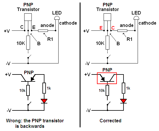

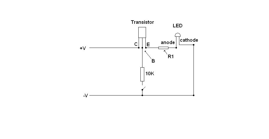

Here is a way i use PNP AND NPN Transistors,im not entirly sure if its the way it is ment to work, but it works perfectly everytime.
the PNP Output(Emitter) is connected to the anode(long pin) of the led and the cathode goes to ground(with a resistor of course)
and the NPN Output(Emitter) is connect to the cathode(short pin) of the led and the anode goes to VDD(+V) (with a resistor of course)
I tried to add a schematic but it said i have reached my max in uploads? so what do i do there?

i hook the collector up to +v, and the small current at base,for testing i used a 10k resistor, and connecting base gives me an high output at the emitter of whatever the +v is, it works.
You said you connected the emitter of a PNP transistor to the anode of an LED. That is backwards.
The emitter of an NPN transistor connects to the anode an an LED. Then its collector connects to +v. The cathode of the LED connects to ground through a resistor of about 1k for the LED to be not bright and not too dim. 10k is much too dim.
The LED turns on when the base is connected to +v.
Your transistor is an emitter-follower without voltage gain. Its output voltage is less than the supply voltage.
if the LED is at the collector of the transistor then the transistor can have voltage gain and the output is almost the same as the supply voltage.
Yes thats right the anode of LED to emitter, and cathode to 0V, and the base goes to 0V with a 10K resistor and the collector goes straight to +V
the emitters output once the base is connected is around the same as +V very high,inuf to kill a LED Quick.
Your schematic is correct and you could destroy the LED without a series resistor. If the transistor is inserted correctly it should work, what PNP transistor are you using ?
I just forgot to add the resistor in the schematic(just added it then), the transistor is a multi-replacment Common transistor pn200 Case(TO-92)
Then according to the schematic you posted, the transistor as shown should have the 'flat' side of the case facing away. Looking at the transistor with legs down and flat with part number facing forwards the pin out is e,b,c.
in the schematic you looked at, that is the flat side with part numbers on it, and its working???????? so is it set up right and i have called it wrong(C,B,E) instead of (E,B,C) which is right
No it is not! Look again. The PNP transistor is backwards.
If its supply voltage is about 9V or higher then the transistor would conduct all the time like a 7V zener diode.
A backwards transistor has a current gain of about 5 instead of a current gain of 200. So it might light the LED dimly.
