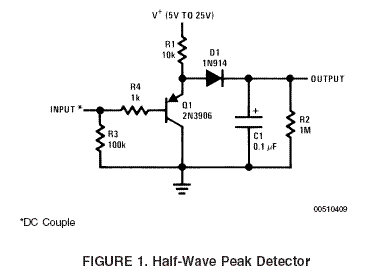

Thanks very much. I dont know what is a envelope detector; a component? a little circuit? Im looking for spanish for that.
It is also called a peak detector. Here is one from the datasheet:
https://www.electro-tech-online.com/attachments/peak_detector-gif.3660/

The LEDs will look like a dim blur without the peak detector circuit shown in the datasheet of the LM3915.

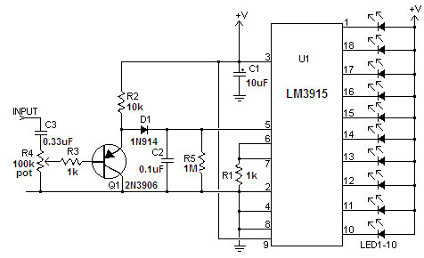

A preamp is needed if you use a microphone as an input.
Here is a circuit of a VU meter with a simple detector circuit. The input can be from your MP3 player.
