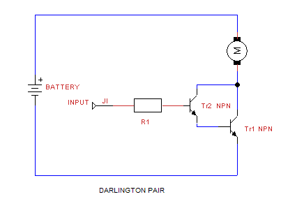

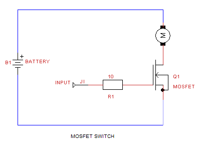

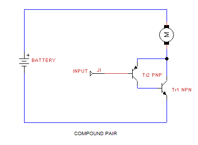

There are two types of transistor buffer, there's the darling ton pair and compound pair. The darlington has the advantage of being able to use the same type of transistor but suffers from a high voltage loss. The compound pair has a lower voltage loss but requires both PNP and NPN transistors.
Using a MOSFET is the best solution since it has virtually no voltage loss and requires no drive current from the microcontroller. The only disadvantage is MOSFETs are more sensitive to static electricity than BJTs.

Hero, If you could explain the darlington pair and compound pair buffers...
Where is the voltage lost in the darlington pair?
I dont see, maybe because I dont fully understand PNPs, how, if the output of the controller is 1 (5v), the motor would turn on.. Since the base of the pNp needs a voltage of 0V to turn on? right?
0.7V plus the saturation losses or two transistors, therefore about 1.4V and more as the current increases, a compound pair looses just 0.7V.
The compount pair I've illustrated behaves like a large PNP transistor, connect the base to 0V in order for it to turn on.

I wouldn't bother though, I would use a MOSFET like the IRL540 that doesn't require any drive current. All you need is a small 10:eek:hm: resistor in series with the gate to prevent oscillation.
I picked up an IRF540 today and it is just what I was looking for.

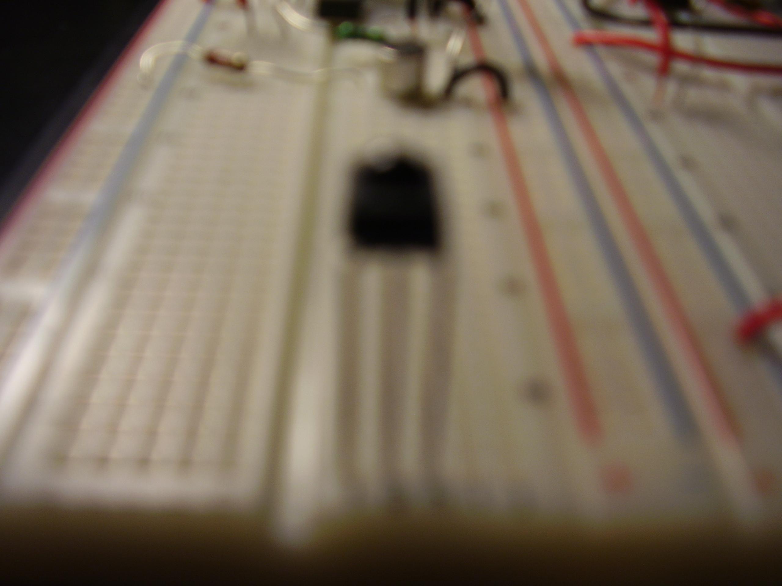

When I was at the store I also picked up this IR RECEIVER (Picture attached)
The box did not have a schemtic of the reveiver so I do not know what each pin is for. Any guesses?
