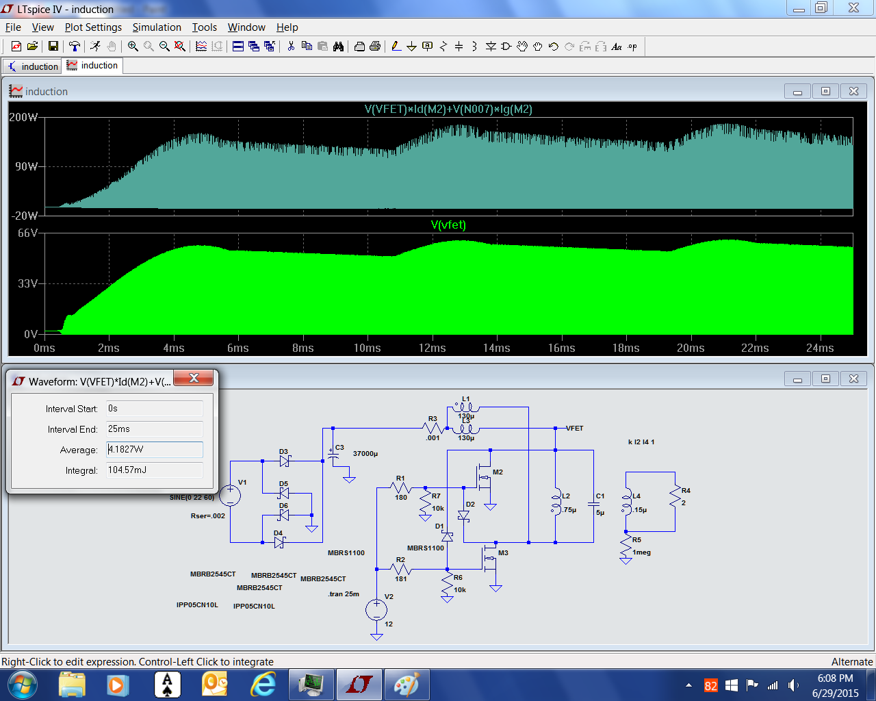

My original circuit was 2 mosfets running on 22 VDC 36 amps. The new circuit used 10 mosfets 5 in parallel on each side. There will be a 1 ohm 50 watt resistor on each mosfet to limit through each mosfet to 22 amps. The aluminum blocks are drilled through taped 1/8 npt on both ends for cooling. Cooling liquid will be high voltage transformer oil. The LC coil size has not been determined yet the plan is 2" diameter with enough turns to limit total current in the circuit to about 65 amps for now. I am going to hook up 2 mosfets at a time once I have it running on 2 then add 2 more the 2 more and so on. 5 mosfets per side is over kill just to keep current lower in each mosfet. The 1 ohm resistors are safety to limit current to prevent a chain reaction just incase 1 mosfet burns up or shorts out. I might only hook up 6 mosfets total for now the transformer is only 68 amps. The gate circuit has its own transformers and power supply circuit so it should not be effected by what the other power supply circuit is doing. The power resistors will have cooling too and so will all 8 power supply 250 amp diodes. I have some 1 ohm and 2 ohm 800 watt resistors i can use for protection to get this circuit going then remove them later. I see I made a mistake on the 22 volt power supply there is no rectifier in the drawing. Give me some help have I made any mistakes?

Maybe you could answer a couple of questions:
What is the ripple current rating of the 7400Ufd filter caps.
What is the current rating of the 8 uh inductors.
What is the length of the heating coil or it's inductance?
Then I think just some drawing stuff:
The caps across the heating coil = .47 ufd X 10 or .047 ufd.???
The gate resistors are marked 1 ohm. S/B 270??

The diode 1N5819 has maximum average current 1A.
With 1ohm gate resistor the current is about 6A.
If you reduce the current to less than 1A, the ripple on the gate voltage is about 8V.
You need a bigger cap on the 12V, about 47000uF

The circuit is a little fussy. There is not a lot of gate drive, so infact putting more FETs in parallel actually makes the hotter because they switch so slow.
The FET you have now is only rated for 55 volts, but due to the resonant circuit it has more like 65 volts across it.
The same is true of the gate diodes. 40 volt diodes with 53 volts across them.
I would make the inductors larger so there current could be lower. It is bad news when they saturate.
The one ohm resistors in the emitter is not a good idea. Think about it -- as the gate goes to 12 volts the FET starts to turn on, but as it draws current the emitter goes positive and it starts to turn off. It will end up somewhere half on and half off and be really hot.
