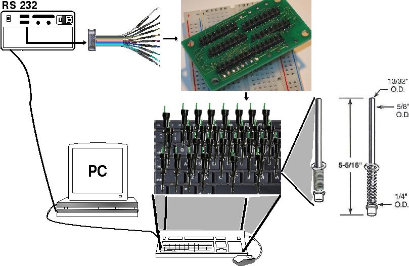

Here is a graphic of what I imagine it would be like..
I am looking for a more independent setup.
Completely independent of the computer. (This is thinking out side of the box)
In fact, the mouse, not needed at all. I have no interest on the mouse.
I am looking for something SO independent, that when you program the keyboard typing relay, that the buttons will depress regardless of there being anything there. Why? Because I don’t want the computer to interfere with its program. (This isn’t what its intended for) but you could have a mock chat relay conversation like an AI. The keys would type, and hit enter.. and the person on the other end would think someone is there. I know we have created better ways to do such a task. (That’s not what I would use it for) Its too hard too explain the how and why I need to build this. I know it is possible. I just have to research research..

It would be far more practical to make a device that you would plug the keyboard into and then plug into the computer, ordinarily the keyboard would be allowed to pass through it's keystrokes, but your device could intercept modify or enter it's own. This would be very easy to do with Ps2 style keyboards but could easily work with basic USB keyboards as well. It is never THAT hard to explain something try a little harder, you obviously have a specific use for this in mind, what is it?
purpose for use
I need to re-image 20 PCs. over the course of the day (xtimes 2). These are not your typical PC. They have different OSes on them. The processes and software changes. I would need to program this RS232 unit to mechanically press buttons I request to be hit. It can be very linear, but timed. instruction - Tap R key wait 1 second, Tap O key wait 1 second.. I type in the same keystrokes. It is not that hard of a job to do. But it is a tedious process that I know can be simplified. Either Find a monkey to hit these strings, or build an unmanned keystroke typing apparatus for the keyboard. Thats it in a nutshell. But its complicated why I cant just program the PC to type this in. This has to be external of the PC entirely. Is this not the best board for the job? I thought the electro tech online tied in to robotics.
I really appreciate your input - I am out of my element on this stuff.
