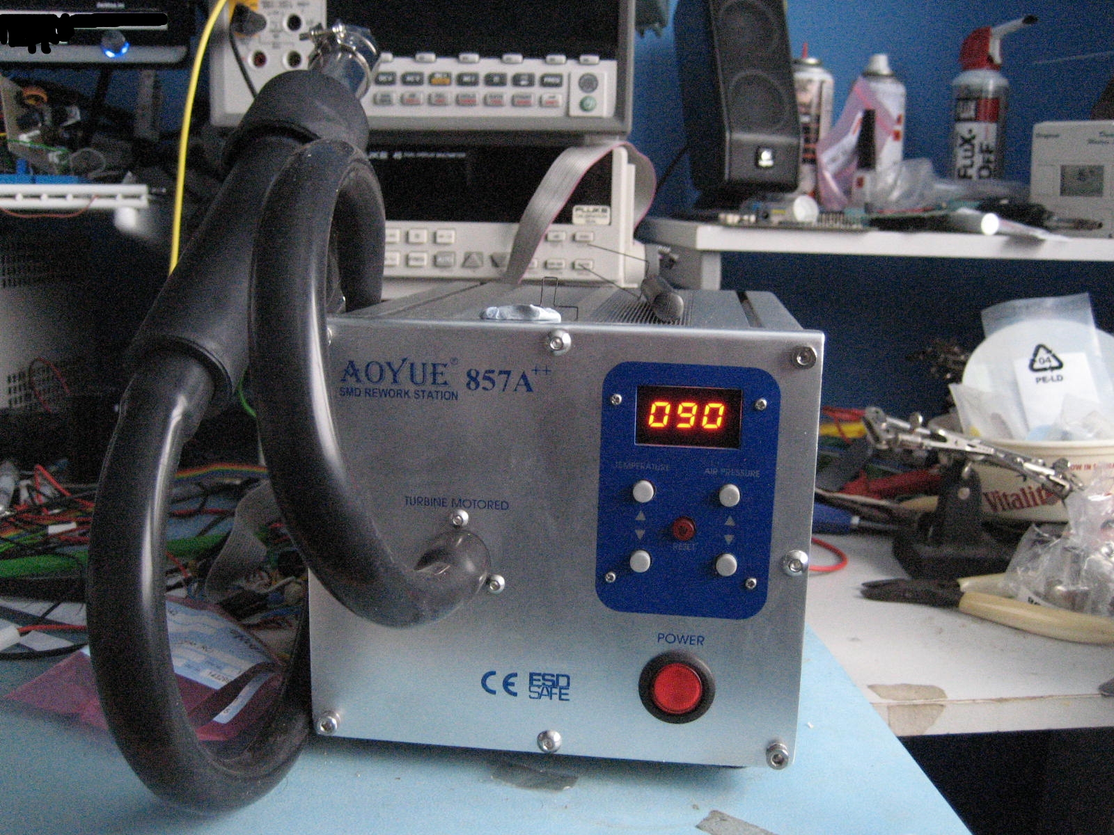

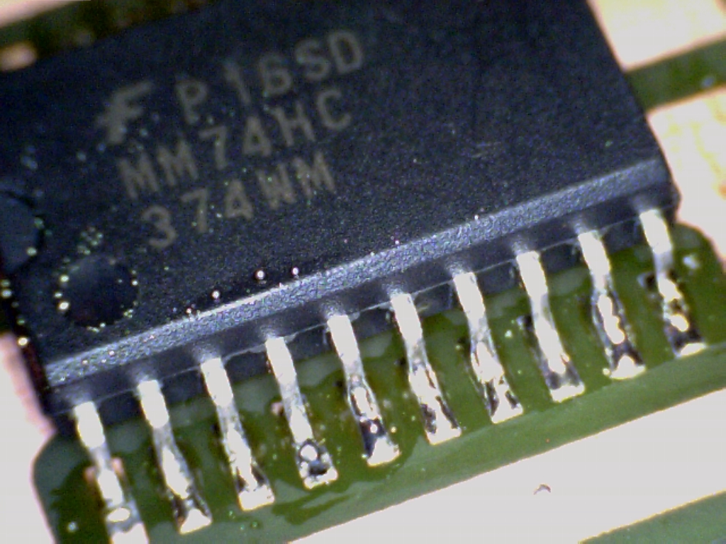

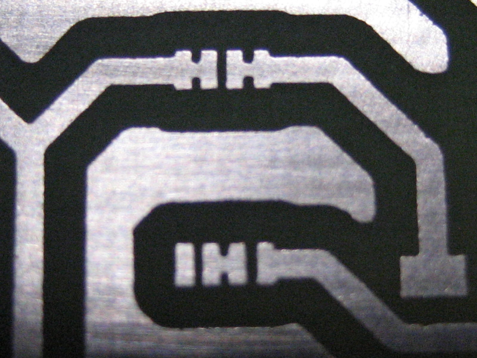

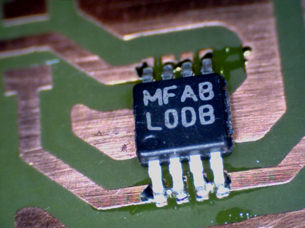

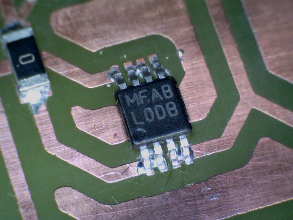

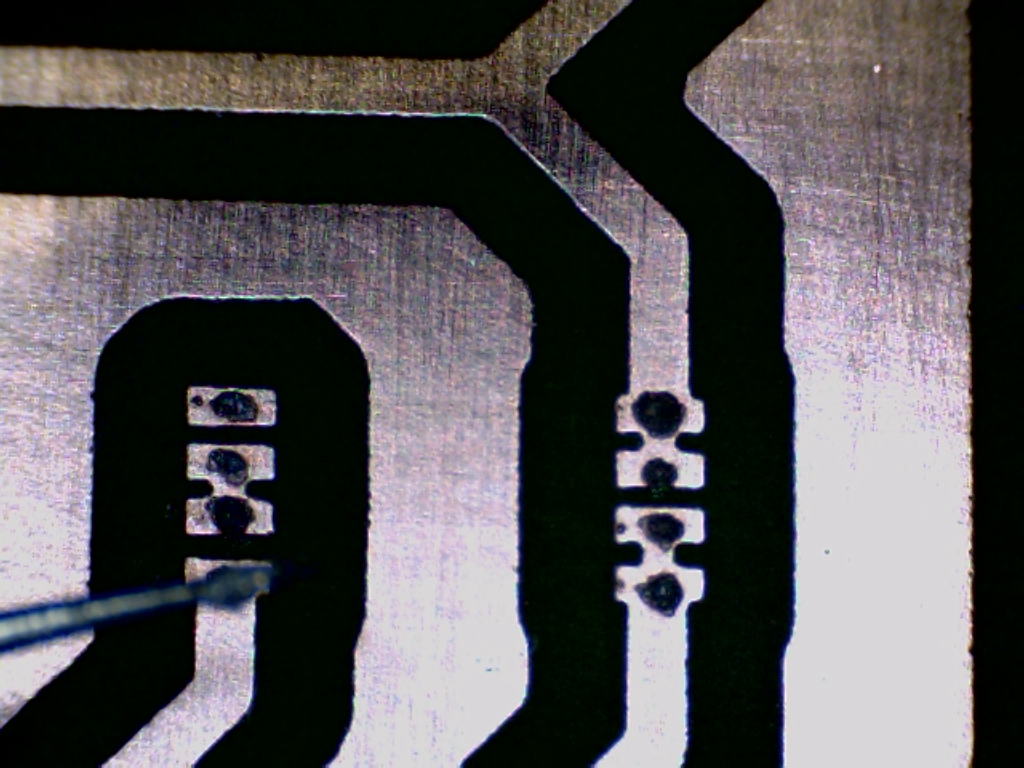

Been playing with new hot air tool......most of the bits removed from scrap oem pcb. Tiniest IC (LP2951 - 3mm x 3mm) I've ever attempted!

How much did you spend on it?
Seems solid.
Did you get some liquid/jell flux? Once you used it for part removal you will wonder why anyone would do without.
Hot air is great for heat shrink tubing too :)
What's this jell flux? How does that work with regard to part removal? Never heard of using flux for part removal but if it eases the process then it sounds like really good stuff to have. Removing some parts using the hot air tool can be tricky when you try not to thermally over stress the part.
I don't know about gel flux, but considering your location, I suspect you need to use and fix lead-free tin-solder joints. ChipQuik is an American brand for a spooled solder-like material that makes a low-melting alloy when added to solder. You add this solder, then remove the component with much less heat. Excess is wiped off the board with solder wick. I suspect is is basically a gallium/bismuth solder. Almost any very-low temperature alloy should work. Avoid alloys with indium, if you have anything with gold plating on it.
John
Flux prevents oxidation of the base metal, soldering or desoldering oxidation is bad. Oxides formed during (de)solder prevent heat flow, generally speaking oxides are insulators!
