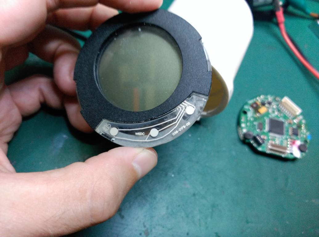

I´m trying to repair a few of these digital indicators. They are from New Eagle (ASM-Gage-002-00). The problem is they are not showing anything.

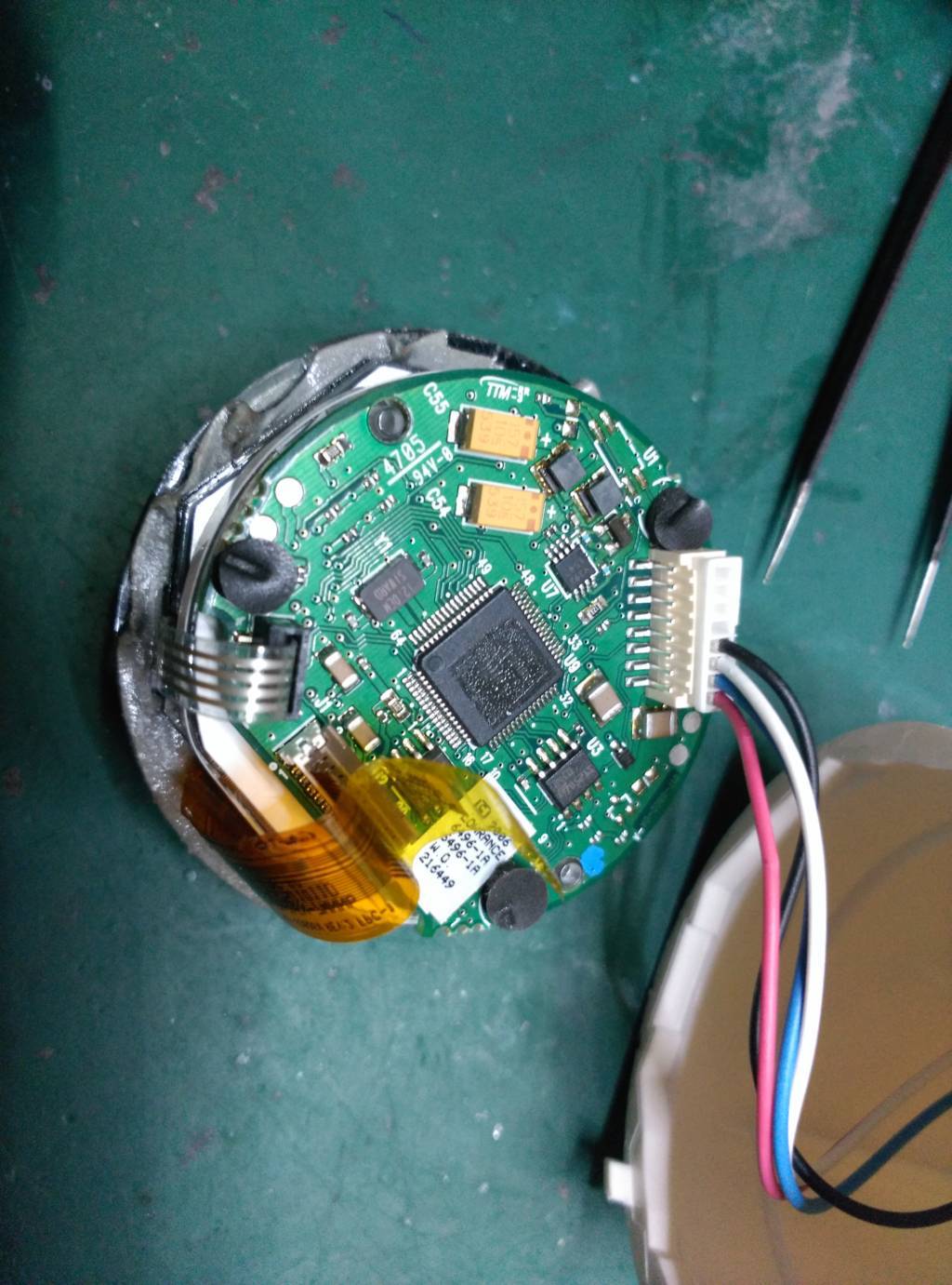

As a main components I have:
L9616D --- CAN communication IC
24C02WP --- Memory
SMD code: NY9Q = TC1185-1.8VRX (Voltage regulator)
5333 SMD (5 pin SOT)= Not sure about that, I thought it was LED driver for back light but it´s not matching in configuration as it should be.
LPC2119FBD64 --- IC microprocessor
KD8 = AZ23C5V1 (OK)
M393 = Comparator. (Tested of circuit)
I have tested the power supply inside, I have 5V, 3,3V and 1,8V.
I have tested the reset at pin 57 of microprocessor and I have 3,57V and oscillator running.
The LED´s for back light are not switching on, I forced them just to see if that was the problem but the LCD is not showing any information.
Now my question is, I´m thinking if the unit needs some kind of external communication signal through the L9616D to start up.
I also would like to know if is possible to test the LCD itself. It has a flat cable from board to LCD.
I´m thinking in these two options, LCD broken or L9616D broken as I don´t see other fault as much as I can check.
It seem it has a common failure as the company who works with this brand told me and they seem to be obsolete. They are installed at yachts to monitor Seakeeper system. Some pictures:
http://www.restoretronic.com/descargas/New Eagle Vista placa.jpg
http://www.restoretronic.com/descargas/New Eagle Vista LCD.jpg

This LCD is working with a flexible flat communication cable, there is not elastomeric.

There are not digital signals, the only oscillating signal is cristal, I´ve checked all the processor pins, mainly I have 5V, 3,3V, 2,5V, 1,8V... but not typical communication signals.
There is not driver IC, it seems the processor is in charge of LCD. The unit was working at the boat and failed for some reason, it´s sun readable but they are not installed at sunny place directly usually.
I have checked at CAN bus IC just when we switch on if we have some signal at TX but nothing.
With this behavieur now I would say the processor is like hanging or damaged partially.
Agreed, is the rom ic part of the processor?, maybe the rom is corrupted, or the checksum doesnt add up and the chip just sits there.
The only other thing you could look for then is a reset i/p to the processor, its probably internal but possibly theres a r/c or a timer ic/supervisor chip in control of it.
Hi dr pepper,
it has internal flash memory. Externally it has eeprom 24C02.
The reset pin 57 at processor goes to a J56C (SMD code) SOT23. It´s connected to 3,3V, ground and reset output, which is in 3,3V. This means it´s some kind of voltage supervisor and send high level or low level to processor (reset active at low level). This pin 57 also goes to LCD connector.
The processor has also I2C bus to drive an LCD or similar.
