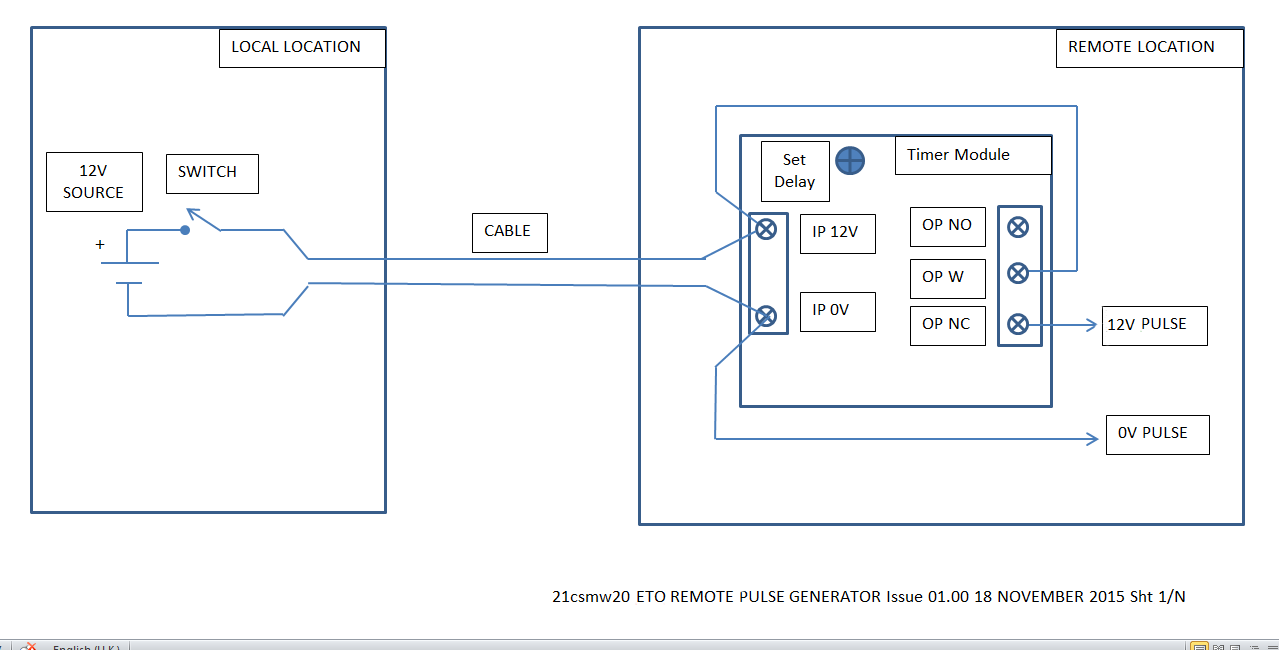

I did a diagram of an approach for you, before the above posts came in.
It is based on my interpretation of what you initially said and also my assumptions about the timer module function. Please don't treat it as a final design because there are a few things to confirm before we can reach that stage. Instead treat it as notional and for discussion. The diagram shows the Timer Module in the REMOTE LOCATION, of course there is no reason why it could not be in the LOCAL LOCATION.
From the picture on the link you posted, you can see that the relay can handle 10A, but it could be that the igniter takes more current than 10A, especially when starting up so that is one area to watch.
One final point: would you be able/prepared to build a simple circuit from scratch? If so we, could do pretty much anything within reason.
The arrangement shown in the attachment works like this:
(1) With the switch open '12V PULSE' will be at 0V.
(2) When the switch is pressed '12V PULSE' will immediately jump to +12V.
(3) After a time, that you can set with a variable potentiometer on the Timer Module, '12V PULSE' will return to 0V.
(4) Whenever the switch is open '12V PULSE' will always go to 0V, regardless of the state of the Timer Module.
You will also need a second timer to prevent the the button from applying power to the high voltage generator if it is pressed again just after the 2 seconds have timed out. You will need to work out how long this delay needs to be from the duty cucle rating of the high voltage power supply. (I am using the term high voltage power supply in place of you use of the term "coil" as DC applied to a coil will only generate one pulse when the current through the coil is removed. If your "coil" behaves in the way you describe then it must also contain some electronics.)
Les.

I didn't have that info when doing the diagram and I see now that it will not meet your requirement.
Les.
Good point Les. These things are always more complicated than seems at first: switch closed and regardless of anything it has no further effect until the pulse has returned to zero and the igniter had had time to cool off.
It would be nice to use the ready built modules as they would save a lot of work. They are dirt cheap on Ebay, so two modules may not be out of the question. Off the top of my head, I suspect that two would do the job, but not sure at the moment.
The exact function of the modules or better still a circuit diagram would be the thing to have. Can any of the other ETO members help?

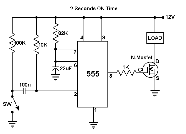

The Capacitor and 555 Circuit I previously described to you, will do what you want.
Depends on What the signal needs to be?
Just a single Capacitor will send a Very Short Signal as power is applied to it.
In conjunction with triggering a 555 timer, it can send a signal of few micro-seconds to 10 seconds or more.

Im trying to make a shocking rat trap. When the rat triggers the switch the hi voltage is a applied for 2 seconds. If the rat dies in place the weight of the rat will still have the switch activated and I dont want the voltage to continue to be applied untill the switch is released.
This Circuit will work for what you want.
If you want a Shorter On Time, a 47K instead of the 82K will give about 1.1 Seconds.
Almost Any Mosfet will be OK.
An IRF640 would be good.
