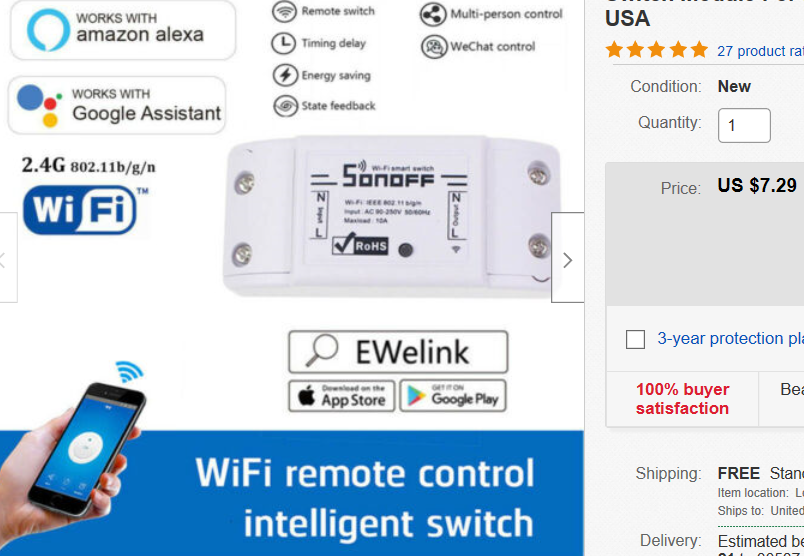

The Sonoff products have 1 to 4 relays. Work WiFi or 433mhz. Some have buttons. All work with a phone and PC.
The TH10 & TH16 have the option to measure temperature and make decisions based on time and temperature.

The Sonoff one does use an ESP8266, and there are various examples of how to reprogram it on the net to make it local control only (as supplied it works via a server, presumably in China, and I had a great deal of trouble registering mine on it - but managed it eventually). It's currently controlling a bedroom table light via Alexa :D

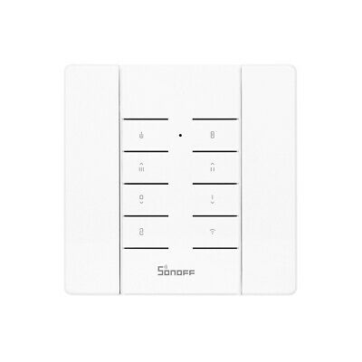

Sonoff and others have buttons in a "remote" looking box. Battery powered.
I am looking at "switch plate buttons" that look like a normal wall switch. The Sonoff ones are only good for 2 or 3A. My idea is not connect them to a light but just leave them sending the on or off command on the network. Then have 15A relays switch to respond to the commands.
Picture of 8 buttons.
