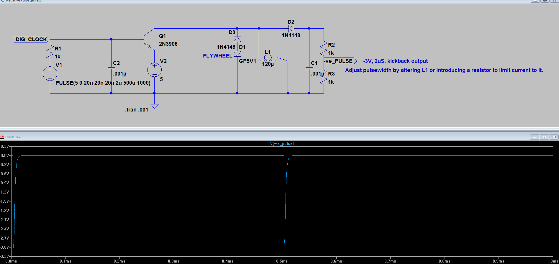

For such a short pulse, I'd go with having a charged inductor with a flywheel clamping to the -3V (resistor/diode combo) being open circuited by your TTL pulse.
If u have a 'scope it's dead easy to evaluate this and size/wind the inductor.
Advantage is that no negative supply is needed.

Here is a spice sim, running at 0.5mS clock intervals providing 2uSec negative going pulses.
  • Negative Pulse gen.zip

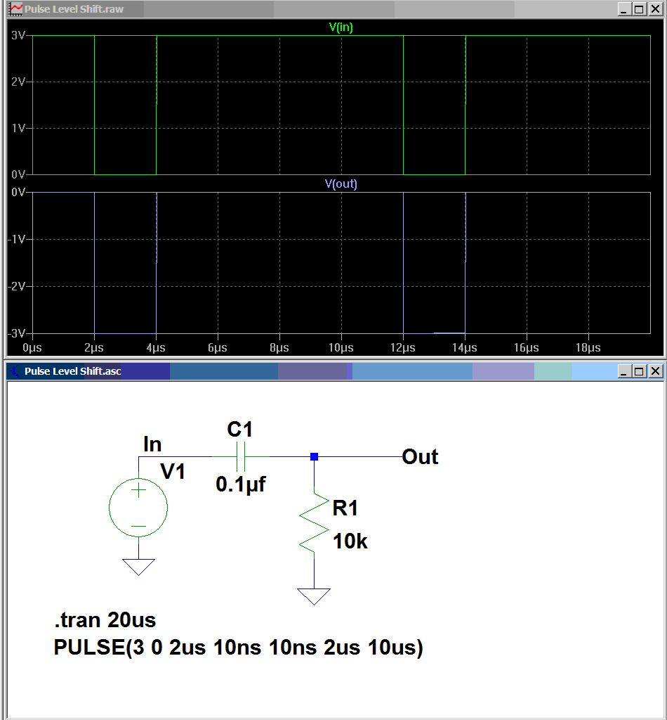

Below is the simulation of an RC circuit to convert a 3v to 0V pulse to a 0V to -3V pulse, which I believe is what you want.
All you need to generate is a 3V to 0V pulse from your micro.
What is the duty-cycle of the pulse?
  • Pulse Level Shift.asc
