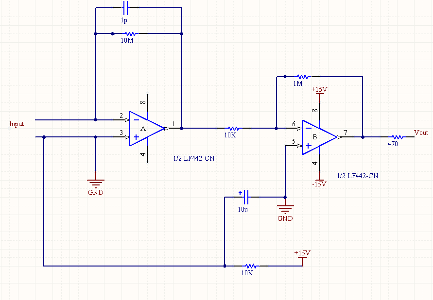

it is for this amplifier circuit. it uses LF442-CN. so i can see it'll require +15V and -15V. am i right?
if yes, how can i supply these voltages?
Are you amplifying ac or dc signals, and ver what range of input/output voltages.?
Do you have a circuit diagram.?
i think its dc. im not sure of input signals but output runs from 0 to about 2.5V or something like that

The input pin3 is grounded, but you have a 10K going to 15V on pin3.? also a 10uF.?
You could consider using a 7660 -Voltage generator ic, running from the +V rail to give a negative voltage.
There are more modern/better devices than the 7660, but it will give you an idea.
If an output voltage of close to 0V to say +2.5Vdc is OK, it would be possible to use a OPA that will work from a single supply.

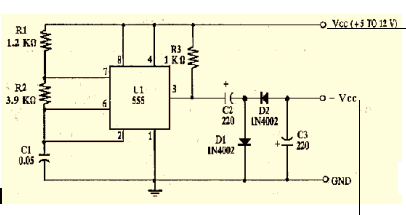

You could build one of these 555's

use this as -V supply?
You could buy an adaptor with 12VAC output and use a diode voltage doubler to get a positive and negative supply.

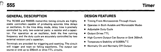

which 555? LM or NE?
hi t,
I would use a TTL version, IIRC they can output about 200mA.
EDIT: added a data extract.

hi, i want to check the items at the store, what values are the caps? i.e is it 220uF and 0.05uF?
They are 220µF at 16Vwkg[min] Electrolytic and a 0.05µF ceramic, a 0.047µF would be OK.
Any of the 1N400x diodes will be OK.
