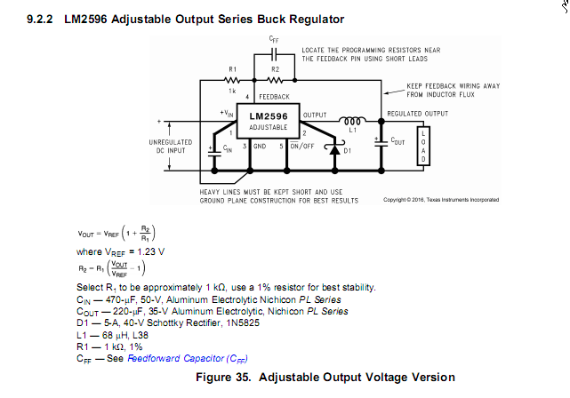

hi nz,
Can you confirm that you have the adjustablle version of the LM2596.?
The d/s circuit is for the 5V version with a 12v input voltage.
I have used the adjustable verison with a 22uH inductor and they work OK.

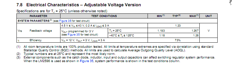

Look at this image.

BTW: The designer will not work me .

Look at this image.
E
I thought the Adjustable version was designed to change the output voltage by means of a potentiometer?
I was going for the 5V version, because thats the voltage I was working with.
Look at the notes on the image I posted , R1 sets the Vout, use a pot with a series resistor.
The 5Vout version is fixed.

OK, I think I understand a bit better.
basically, you are saying that you have to design the unit to work with the voltage being fed in, so in other words, if i wanted to change to 24v from 12v, I would have to trim the pot to get me back to 5v?
Im sure ive seen buck converters out there that you can connect to virtually any voltage between 6-35v and out comes 5v without any tweaking.
If its too difficult to design this, I may as well just leave it for 12v operation, but it would have been nice if I could have simply connected the unit to any power source and still got 5v.

With the 5V version the Vout will be fixed at 5v.
If you drive it with say 24v it will give 5v=Vout, but the heating of the LM will mean heat sinking the LM when operating at high current outputs.

OK, thats good to know, this is what I suspected under load, but TBH - I dont think that this will be a problem.
Im only running an arduino UNO, an LCD screen and 2 small sugarcube 5V relays, I doubt this would even use 1A, going by the current these small relays draw.
The LCD probably uses more than the arduino and relays combined.
I could heatsink it to the metal box anyway.
For such a light load current, I would try it without a sink and measure the TAB temperature, check if it needs sinking.
