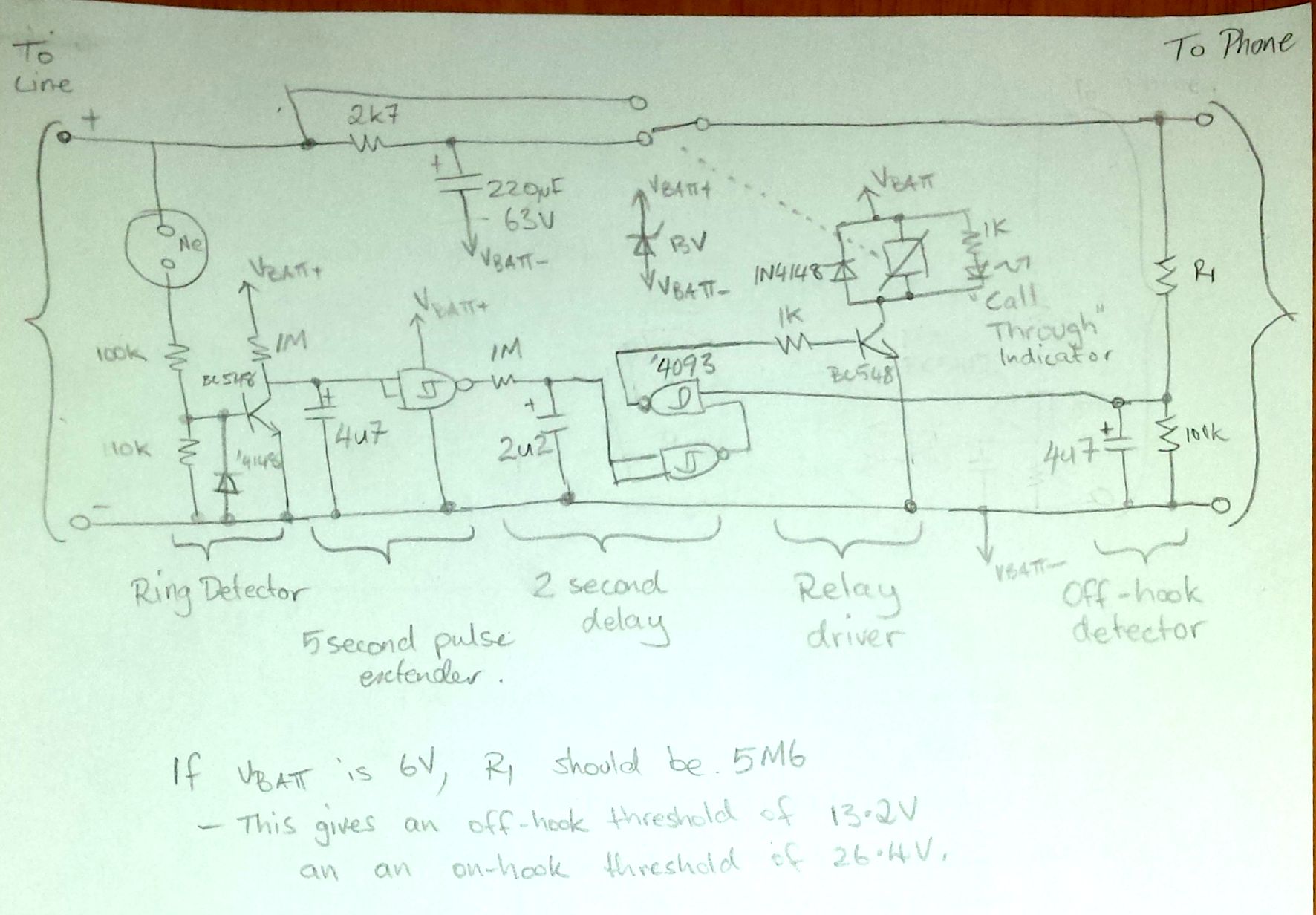

I am one of the folks that is geting numerous telephone calls from unidentified scammers.
I recently purchased a "Digitone Call Blocker" thinking it would solve my problem.
Well, it has helped, but all calls are allowed one ring before being trapped by the blocker.
I need that one ring delayed a few seconds to really nab these anoying calls.
ANYONE got any ideas?

Here's an idea for a circuit (attached); basically when the relay is not activated, the ringer voltage is filtered out by the 2K7/220uF.
If the ringer signal is detected by the bit on the left (the neon, cap, transistor, NAND gate), it starts a pulse extender timer.. which feeds into a delayed-on timer which drives the relay and connects the phone to operate normally to ring, talk, etc.
If the phone is picked up, the transistor in the middle operates and turns on the relay also - this way the phone can be used to call out as well.
Anyway, just an idea, values & concept may be a little rough but may be something to get you started.

Edit: In the circuit, I'm thinking the ring filter will also filter out the 1200 baud tones containing the caller ID info unless the filter is switched-out immediately after the first ring completes? Good idea to suppress the first ring, somehow, rather than to delay it. The Call Blocker may rely on the first ring as a prompt to ready for the caller ID info, so if the circuit is placed before the Call Blocker, the Call Blocker may not function at intended, maybe. I don't know. If placed after the Call Blocker, then that's not an issue, except maybe the following phones won't display caller ID info.
The circuit I posted is to go between the call blocker and the phone.

I don't have a copy of the old schem, nor can I remember what it was. Here's a circuit based on parts of the description above which may (or may not) do the trick.
The circuit is powered from a battery but doesn't use [virtually] any battery power when idle. You could connect a high-value resistor between the positive of the line and the positive battery terminal to allow a rechargeable battery to be recharged from the line between calls.
You shouldn't use a mains adapter to provide power to the circuit.
I take no responsibility for how this circuit is used or misused or any damages caused. Use at own risk.
