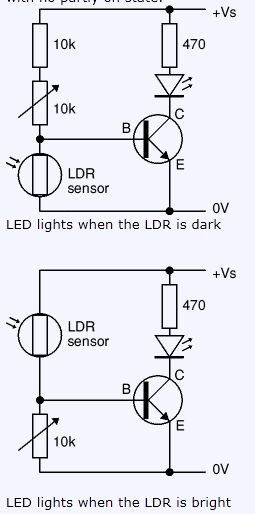

need your asssistance on getting my ldr to light up
Dentsu
i have been trying to get my ldr to light up for some time now and i am getting frustrated. i am probably doing it wrong or maybe using a wrong component? the closes i got was when i changed the location of - from the battery to the led anode and it would light up but just for a sec then it would then die off. when i cover my ldr in this position there is a really dim glow. trying to get a dark senor working. any tips for a total newb?
50k potentiometer (15 turns)
normal white led
390 ohm resistor
bc547 transistor
unkown photoresistor

so i had time to do some testing and found out that the ldr resistance i am using is around 0.2(200M) in complete darkness and 0.92(20K) near my fluorescent bulb. i also measure the resistance at the ldr location and it was at 30k and i just lower it to better match the schematic. i need mine to go on at around 12(200K) mark. i am positive i got the anode and base, collect, etc in the right order.

If average light hitting the LDS gives you about 30 K Ohms at location they you may want to increase the pot value in the circuit to 50 or 100 K ohms. Also you can place some voltmeter leads between the LDR and Resistor (the transistor base) and ground. When the circuit is on observe the base voltage. When the base voltage to ground is about .6 to .7 volts the transistor should be turning on. When that happens the LRD should turn on.

Something here has to be wrong. This is not a complicated circuit. Looking at the first image "LED lights when the LDR is dark". Just look at the resistors. Starting at the top we have a fixed value 10K resistor in series with a 10 K variable resistor (the one with the arrow) followed by the LDR. You are I assume wiring the variable resistor as just that correct? It should have 3 legs and the center leg is tied to one end. So the fixed resistor, the variable resistor and the LDR all form a series voltage divider.
If for example in theory all 3 resistors were 10 K and 9 volts were applied then about 3 volts would be on the base of the transistor. The numbers you posted for base voltage lead me to think maybe the pin out for the transistor is wrong? Anyway with 3 volts on the transistor base it would be full on (like a switch) and the LED would be lit. That assumes the LED polarity is correct.
When the light striking the LDR increases the LDR resistance will decrease and as that happens the current through the resistors and LDR will decrease. In turn the voltage on the base of the transistor will decrease until the transistor shuts off and the LED goes out.
Matter of fact if you simply remove the transistor from the circuit (just yank it out of the circuit) you should be able to measure the voltage at the junction of the LDR and the resistors above it and ground and watch the voltage change as the LDR goes from Light to Dark.

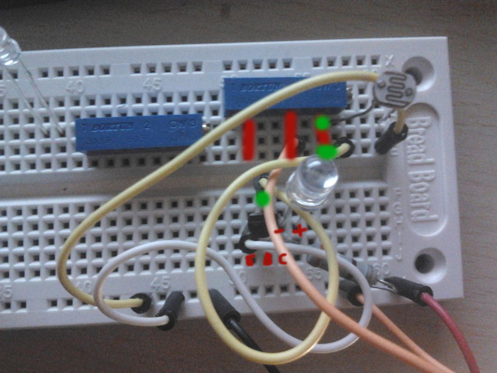

didn't know i had a reply but i think the solution is something simple like incorrectly connecting the wires so i have uploaded a picture of it current state right now. i hope this camera shot show up clearly and this is how i interpret the schematic.

... Suggest that you check the continuity of the 5 hole groups along the lower edge of the breadboard. If the breadboard that you are using follows standard convention, all of the wire holes along that bus are connected. Try using the lower Y bus row for ground, and the upper X bus row ... at the top of the picture ... for Vs ... or vice versa.
OMFG. that was the problem...it is now working perfectly. thanks a bunch!! i knew it must have been something stupid like this. :)
