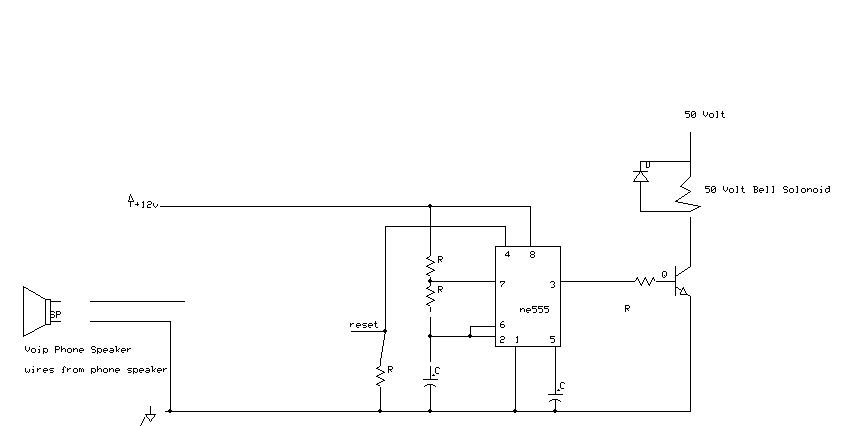

Hi
Sorry about the lack of info on my previous post, I have the following ne555 circuit working to ring the bell when the reset line is pulled High.
What im after is some idea on how I can connect somthing to the speaker wires on the voip phone and then to a pnp transistor on the ne555 reset line to +ve. so that when the speaker has sound on it the ne555 will turned on and when the speaker has no sound the ne555 reset would be held low.
The sound would be Ring-------Ring------Ring. The ne555 needs to run during each ringing sound.
Would using a lm386 opamp chip to amplify the speaker sound and then on the output of the lm386 use a combination of resistors and a large capacitor to make the output stay on for longer.
This could then turn on a pnp transistor between the reset line and 12volts.
Is this the best way to try it or are there other ways to do this.
Nick

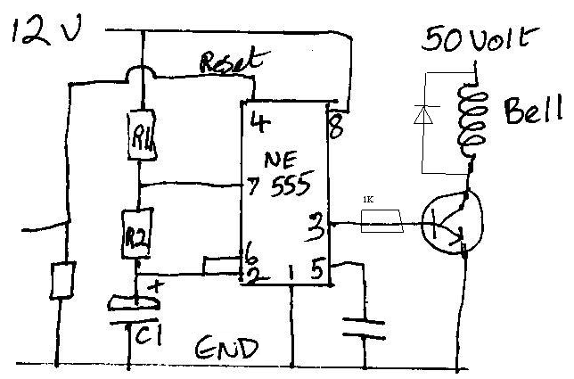

I have redone the circuit I have used so far so is better quality. Sorry but I did not read the faq first.
Its quite basic timer which just goes on/off several times a second and drives a transistor which drives a solinoid to ring the large metal bt bell. The ne555 will only ring the bell when the ne555 reset line is pulled high as its by default pulled low by the resistor to gnd. This works great.
Sorry but I dont have the values of the resistors or caps as the circuit is at work and im off for a while.

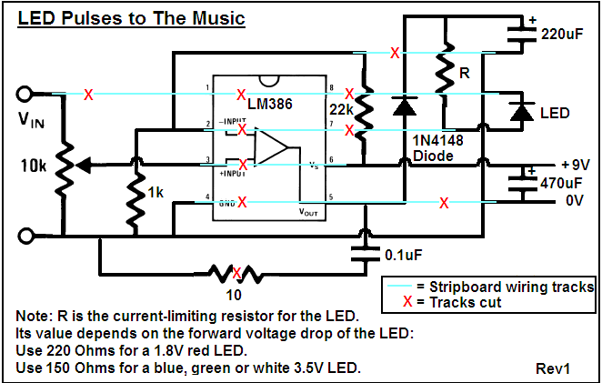

What im looking for is some circuit to attach to the voip phone internal 8ohm speaker which only sounds with the phone rings and the ne555 reset line. The idea is the ne555 reset line would be made 12volts only when sound is heard through the speaker.
I had thought about trying the attached circuit from the led music pulses topic. I Could increasing the 220uf cap to somthing larger make the led stay on constant when the phone rings and off between the ringing sound. If this would work i should be able to connect it to a pnp transistor or opto coupler between the ne555 reset and 12 volts ?
Does this sound possible.

You don't need another amplifier.
The phone's speaker amplifier should be able to drive the LED in the opto-isolator through a coupling capacitor in series with a current-limiting resistor, then the output transistor in the opto-isolator could drive a PNP transistor through a voltage divider to its base. A capacitor could filter audio from the reset wire.
