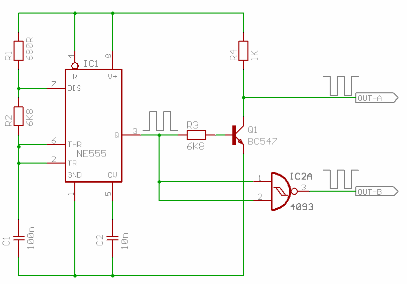

I need to invert the output of a 555 mono. I'm sure there's a chip for that but darned if I can find what I need, or can I do it with a Schmidt Trigger circuit?
You forgot to say how much current the inverter must supply.
An ordinary transistor can be an inverter.
You could use another 555! It's not the most economical way, but if you hook TR and TH as inputs, the OUT pin is inverted.
Or do it that way :)

Use the NE556 dual 555 timer, then it's just one IC.
Thanks....
Thanks guys....I must have been having a really bad hair day. I'm using 556's and of course the solution was right in front of me.
