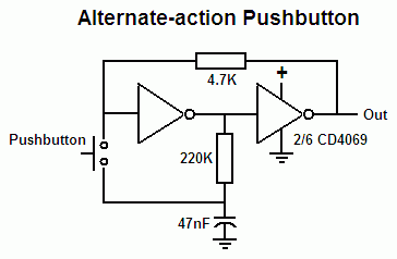

An 8-pin dual opamp can do it like this one:
