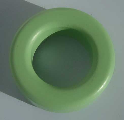

I need Circuit diagram of SwitchMode adjustable Voltage Regulator
The features of the circuit should be:
- Transformer less (transformers are heavy and wastes electrical energy more (as heat)
- Should be able to take input from 220V AC and also 9V DC (Battery) (if single diagram can’t do both, 2 different diagram will also be ok)
- Voltage adjustable (30V – 6V) , little more or less is OK.
- I prefer LM317T IC (as it is easily available and I’m familiar with it)
- If Inductor is used, description of the inductor (how to make it, readymade inductor is not available in my place (Bangladesh) )
Can anyone please help me?
Note 01: I got an inductor core (like the attached pic) which has around 50 turns of wire (may be 18 / 19 Awg). Can you guess the specification of the core and how to build inductor required for the circuit.
Note 02: Does AWG of wire matters, if yes, how

One more request. Can you tell me about the Inductor core in the pic (Identification, parameters). How can I make a 600uH inductor with it.
thanks again
Polash
Guessing at the size and composition of the core and assuming that it is about 1” in diameter and permalloy dust, I come up with a fraction of a turn for 600 μH. Not a good choice for a choke that size. For something that small I would go with air core, especially if you are operating in the UHF band where a choke that size makes sense.
My intention is to make a 600 uH inductor in a voltage regulator circuit (IC LM317T)
