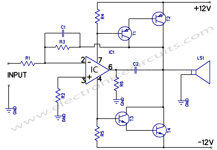

TODAY i need to make an alarm system, so if it happens at night again (its always at night!) i can run down and change the bulb, i cant put 2 bulbs inside there isnt room. I can make a simple LDR ladder connected to a micro no problem, i can make simple sirens and bleep and tones with the pic, no problem.
The bit i need help with tho, is they are not loud enough as is. As i need/really want to make this now, i have to use what is here.
i am not asking for circuits or stuff like that as i can go look for that on net, or maybe design myself. But i do need to know what kind of amplifier i need to make so i can connect the pic sound out put to it and have it drive a speaker loud.
I have some small pc speaker's to hand (speakers not those buzzer things), they are 8 ohms, i have some other speakers that are in a cupboard somewhere that i think are 16 ohms??? not sure on this, but from memory i know they are around 3 times larger in size than the pc ones and higher in ohms, 16 Ohm's just rings a memory, but might not be right, i will try and get them down in a bit.
So what kind of amplifier configuration do i need? and i forgot to add the brooders are in a room below mum and dad's bedroom, i tried the pic and speaker sound, and it cant be heard in there room as it is now.
In a ideal world i would like 120 db or something as loud as a car alarm or smoke detector. But i will settle for any gain, the sound dose not have to be pretty, distortion and noise dose not matter. What matters is its loud! so as a figure of the top of my head, i would like to aim for say 80 db, but obviously will go with whatever i can get.
So what kind of amplifier do i need to build for this? and what components do i need?
And honestly i dont expect anyone to do the work for me, but i am not sure what kind of circuit i should be building, i know i need an amplifier but what kind sort of thing, this will get me on my way at least

My first thoughts are to suggest something like an LM386 amplifier IC. Not the loudest thing on the planet, but able to make a noisy noise to attract attention.
As I am typing, it occurs to me that you may have something in your "junk pile". A redundant radio or "hifi", use the audio amp from something like that.

Tda 2030 is a good amp ic with built in heatsink tab and it'll work from a 12v battery, and make a lot of noise, google for a datasheet.

ok i thought i had a amp chip, but its not what i thought it was, It is a AD 815AVR, could this be used?

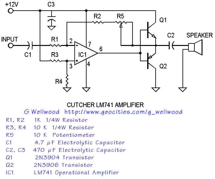

or can i use say ordinary opamp and fets in some configuration? i have inductors but no buzzer thing. Will be at least 4 days before i could get parts here, so having to make do with whatever i can find here. Must be something i can build with all this junk!
no external speakers and i have the internal one in my hand :D

ok found 2 that are not great but might get me out of a hole.
I except they wont be anywhere near the volume i hoped for, but worth a try. I will try and sim it first, see if it's worth building
